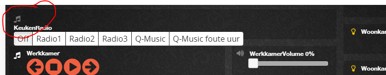

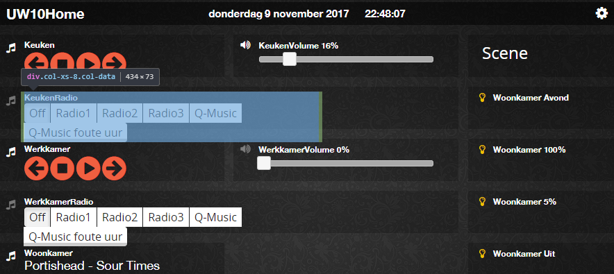

I've got an issue with selector switch not using complete available space
Somehow the complete available width is not used, I've checked CSS, but did not find an indication there (not an expert however...)

pvm
Posts: 550
Domoticz version: 4.10538
Re: Dashticz - Bug report
Post by pvm »
This did improve a lot, got a strange detail back (icon and title not on one line)
robgeerts
Posts: 1273
Domoticz version: 3.7067
Post by robgeerts »
@pvm, could you tesst latest version?
(Sorry, hard for me to fix as it could respond different at other screen resolutions).

pvm
Posts: 550
Post by pvm »
robgeerts wrote: Friday 10 November 2017 9:26 @pvm, could you tesst latest version?
Done, fixed! Thanks
