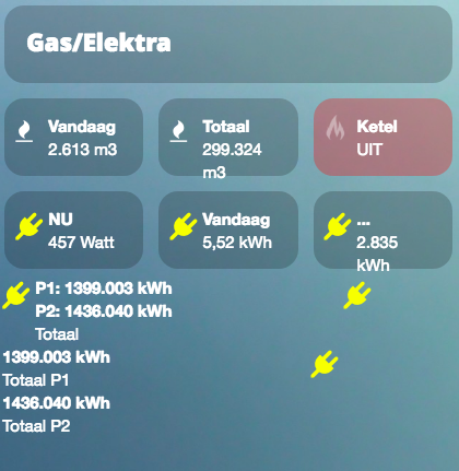

Om domoticz I've got
Total Usage: T1: 352.404 kWh, T2: 355.628 kWh, Total: 708.032 kWh
Counter: T1: 1390.844, T2: 1425.269
How can I get those counters and usage in blocks?
The JSON output for electra is. The data block seems to be the most interesting, as it hold the counters for T1 and T2
"Data" : "1391038;1425269;0;0;595;0",
I don't know what the other data is.
"ActTime" : 1514320158,
"AstrTwilightEnd" : "18:42",

robgeerts
Posts: 1273
Domoticz version: 3.7067
Re: Dashticz - Feature Requests
Post by robgeerts »
Could you try this in latest beta:
columns[1]['blocks'] = ['199_6','199_7','199_8']
EdwinK
Posts: 1820
Location: Rhoon
Post by EdwinK »
Screen Shot 2017-12-28 at 12.10.58.png (227.48 KiB) Viewed 5318 times
Yes. Works.
