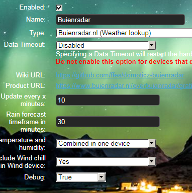

Think I've got it all covered:
Even if I fill in 1 minute in both fields, it doesn't get updated.

I removed the 'Hardware', rebooted and added the hardware again, with the standard variables. Still not seeing the selection of the nearest weather station and no updates of the mentioned devices.

Still not getting anything like this in the onscreen log. Is there a log being written to the Pi?

i assume you have debug set to true in the Hardware setup of Buienradar plugin?

Set it both to True and Logging. All I get is:

2017-10-18 14:42:03.631 (Buienradar) Stopped.
2017-10-18 14:42:03.632 (Buienradar) Started.
2017-10-18 14:42:04.039 (Buienradar) Entering work loop.
2017-10-18 14:42:04.039 (Buienradar) Initialized version 2.0, author 'ffes'
I'm on the latest Beta.
