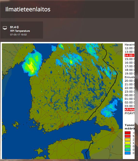

koowee wrote:
tontze wrote:Hi !
I was trying to get Wikis weather frame to work, but it makes screen blank .. I have done as wiki says :
var frames = {}
frames.weather = {refreshiframe:10000,height:500,frameurl:"http://iltasanomat.weatherproof.fi/tutka.php?map=Etel%C3%A4-Suomi",width:12}
columns[1]['blocks'] = [frames.weather];
I think that you need to add more parameters to "columns", try for example this
var frames = {}
columns[1] = {}
columns[1]['width'] = 4;
screens[2] = {}
screens[2]['background'] = 'bg1.jpg';
screens[2]['columns'] = [1]
Thanks, now other buttons are visible, and weather has reserved its space from the screen, but there is nothing in the reserved space :/

Strange.. Have you cleared browser cache? Can you disable everything else and only allow and test with this weather frame? I did just test this with fresh installed dashticz and it work.
Related to this, can someone help to rescale / resize this source to smaller (css magic or something else :) )?
http://iltasanomat.weatherproof.fi/tutk ... 3%A4-Suomi

koowee wrote:Related to this, can someone help to rescale / resize this source to smaller (css magic or something else :) )?
In your config.js you maybe should fiddle with the width setting in:
make it for instance width :4 or something....
Hope it helps...

Thanks, unfortunately it didnt' help. I did change width to 4 and then it lose some part of the picture (see attachment). I think that the problem is that the source is fixed size and it doesn't automatically scale it smaller to this iframe. Maybe this can be done somehow for example using css (I don't know anything about css :cry: ).

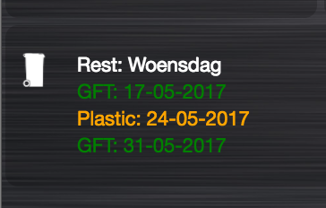

Although I meant it a bit different from what you did here: The text can be white, just like all other texts. It would be handy if the icon could change color. No big deal, but it might be nicer in the total dashboard.
Now it shows this when you use the color options and the renaming options (thanks for that !):
Oh: any chance this can be fixed for the Safari browsers that still show the "invalid date" message :) ?

Yes, i removed everything else, no go :/ Tested with 2 different browser and 2 different computer..
var _LANGUAGE                   = 'en_US'; //or: en_US, fr_FR, hu_HU
var _HOST_DOMOTICZ              = 'http://192.168.x.xxx:8080';
var _DOMOTICZ_REFRESH           = 5; //in seconds
var _DASHTICZ_REFRESH           = 30; //in minutes
var _THEME                      = 'default';
var _HOST_ZIGGO_HORIZON         = ''; //e.g. http://192.168.1.3/domoticz/switch_horizon.php';
var _APIKEY_WUNDERGROUND        = '';
var _WEATHER_CITY               = '';
var _WEATHER_CITYNAME           = ''; //show a different city name, leave empty if same as _WEATHER_CITY
var _WEATHER_COUNTRY            = 'NL';
var _USE_AUTO_POSITIONING       = false; //don't want to configure positions, use auto positioning
var _USE_FAVORITES              = false; //only used when using auto positioning
var _HIDE_SECONDS_IN_CLOCK      = false; //do not show the seconds in the clock
var _HIDE_MEDIAPLAYER_WHEN_OFF  = false; //when you have a mediaplayer connected, hide it if nothing is playing
var _NEWS_RSSFEED               = 'http://www.nu.nl/rss/algemeen';
var _USE_FAHRENHEIT             = false;
var _USE_BEAUFORT               = true; //Bft instead of m/s
var _TRANSLATE_SPEED            = false; //windspeed, north northwest instead of NNW
var _STANDBY_AFTER_MINUTES      = 10; //enter amount of minutes like: 5 (5 minutes)
var _SCROLL_NEWS_AFTER          = 7000; //milliseconds, so 7000 is 7 seconds
var _SHOW_LASTUPDATE            = true;
var _LASTUPDATE_FORMAT          = 'DD-MM-YY HH:mm';
var _SCREENSLIDER_EFFECT        = 'slide'; //'slide' or 'fade' or 'cube' or 'coverflow' or 'flip'
var _APIKEY_MAPS                        = '';
var _MAPS_LATITUDE                      = '';
var _MAPS_LONGITUDE                     = '';
var _AUTO_SWIPEBACK_TO          = 1; //when no activity, swipe back to main screen after x seconds
var _AUTO_SWIPEBACK_TIME        = 10; //seconds
var columns = {}
//Sää
columns[10] = {}
columns[10]['blocks'] = [frames.weather];
columns[10]['width'] = 12;
// Sää
var frames = {}
frames.weather = {refreshiframe:10000,height:500,frameurl:"http://iltasanomat.weatherproof.fi/tutka.php?map=Etelä-Suomi",width:12}

tontze
Posts: 317
Joined: Thursday 12 January 2017 15:30
Domoticz version: Beta Ch
Location: Finland
Post by tontze »
koowee wrote:
tontze wrote:
var columns = {}
//Sää
columns[10] = {}
// Sää
var frames = {}
You need to change order of the code. First define variable frames and then use it on columns
// Sää
var frames = {}
var columns = {}
//Sää
columns[10] = {}
Works! I didnt know they need to be in some sort of order :) Thank you :)
