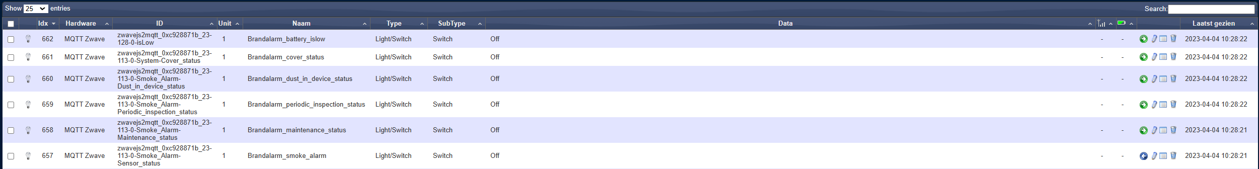

Had some time to spare, and some issues with a zwave node, so gave it another try... Cant get replace to work at all, since i can't have both plugins enabled at the same time. Also, still some devices unsupported.
Thirdly, my smoke alarm got added by MQTT Auto discovery. However, it's not updated rightly.
MQTT shows a change at 10:30, when i pushed the test button:
2023-04-04 10_41_31-MQTT Explorer.png (93.43 KiB) Viewed 6953 times
However, it isn't updating in domoticz:
2023-04-04 10_41_58-Thuis en nog 8 andere pagina's - Profiel 1 - Microsoft​ Edge.png
2023-04-04 10_41_58-Thuis en nog 8 andere pagina's - Profiel 1 - Microsoft​ Edge.png (66.92 KiB) Viewed 6953 times
Any thoughts? Domoticz log is quite empty

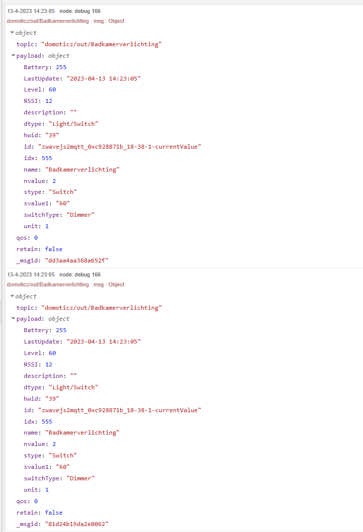

Only thing i'm now noticing is that Domoticz seems to send double MQTT messages.
Re: Easiest way to migrate Openzwave to ZWave-JS-UI
Posted: Thursday 13 April 2023 14:19
by thomasbaetge
Did you set the 'prevent loop' setting in the MQTT Gateway settings in Domoticz to 'true'?
If it is on 'false' that may cause the issue.

thomasbaetge wrote: Thursday 13 April 2023 14:19 Did you set the 'prevent loop' setting in the MQTT Gateway settings in Domoticz to 'true'?
Yup it's set to True.
The issue is independent of any actions i'm doing in Node Red/MQTT.
It just always sends two messages.
This is one "switch on" command:
2023-04-13 14_24_24-Node-RED _ 10.0.0.4 en nog 8 andere pagina's - Profiel 1 - Microsoft​ Edge.png
2023-04-13 14_24_24-Node-RED _ 10.0.0.4 en nog 8 andere pagina's - Profiel 1 - Microsoft​ Edge.png (33.4 KiB) Viewed 6893 times
