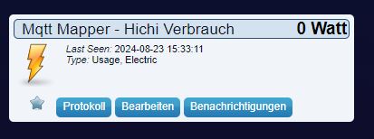

I need to come back on this issue. I have good experiance with some othe devices delivering data to MqttMapper. But the tasmota didn't and I do not find the trick.FlyingDomotic wrote: Thursday 22 August 2024 16:11 They're 2 classical things that may cause issues:
1) published data is not marked as "retain". In this case, MqttMapper won't be updated until value changes. It's generally a good idea to flag topics "retain", as readers staring after last update could see last value.
2) you made changes into device type/subtype/switchtype/options not allowed by Domoticz. In this case, you have to delete device and restart plug-in in order for a new one to be crated with last settings.

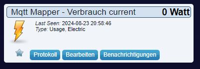

this can be seen in the console of the Tasmota unitFlyingDomotic wrote: Friday 23 August 2024 16:27 To help, i need (part of) configuration file showing the incriminated device, and content of MQTT topic used in configuration file.
19:38:45.955 MQT: tele/Hichi_F42ED0/SENSOR = {"Time":"2024-08-23T19:38:45","SML":{"server_id":"0a01484c590200155d58","export_total_kwh":0.0000,"total_kwh":1760.8927,"curr_w":532,
this is shown in the MQTT Explorer (no idea why twice) tasmota and tele And this is what I added to the MqttMapper.json
"Verbrauch current":{
"topic": "tele/Hichi_F42ED0/SENSOR",
"type": "248", "subtype":"1",
"mapping":{"item":"curr_w"}
and here we have the result

this is the error log
2024-08-25 12:33:46.063 Error: Mqtt Mapper: Can't find >curr_w< in >{'Time': '2024-08-25T11:33:45', 'SML': {'server_id': '0a01484c590200155d58', 'export_total_kwh': 0.0, 'total_kwh': 1771.478, 'curr_w': 953, 'volt_p1': 236.1, 'volt_p2': 236.5, 'volt_p3': 234.7, 'amp_p1': 1.9, 'amp_p2': 2.8, 'amp_p3': 0.1, 'phase_angle_l2_l1': 120.0, 'phase_angle_l3_l1': 240.0, 'phase_angle_p1': 339.0, 'phase_angle_p2': 36.0, 'phase_angle_p3': 285.0, 'freq': 50}}<
FlyingDomotic
- Posts: 477
- Joined: Saturday 27 February 2016 0:30
- Domoticz version: 2020.2
Re: Python Plugin: MqttMapper
I should have been seen that before, it was in your screen dump, sorry...
Value "curr_w" is not as root level in the topic, but in the "SML" branch. So its name is "SML/curr_w" instead of "curr_w".
Try to change: by
Try to change:
"mapping":{"item":"curr_w"}Code: Select all
"mapping":{"item":"SML/curr_w"}-
thaui
- Posts: 61
- Joined: Sunday 15 March 2015 19:53
- Domoticz version: 2023.2
- Location: Hamburg
Who the hell is so experianced to understand this details. This did the trick. Thanks a lot.
