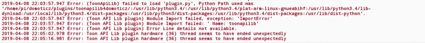

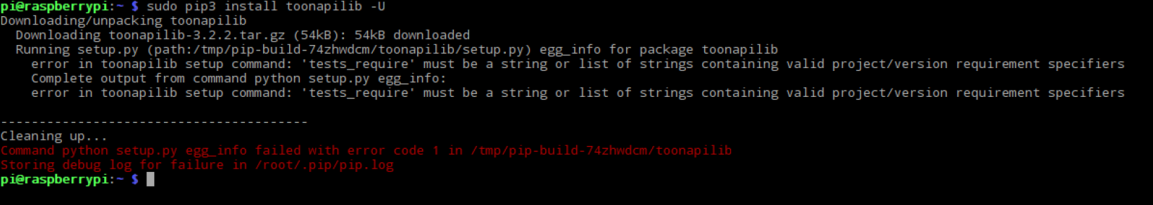

Hi finally got some time to get this thing going.. i thought..
I bumped in trouble i think when i started installing?
Aantekening 2019-04-08 215831.png (170.21 KiB) Viewed 4161 times
i dont know if this was good or wrong.
the rest was clear and simple.
one thing that was strange for me was in the readme file the folder dev-domoticz was used, mine is just called domoticz. so changed that.
maybe this causes the next screenshot?
Aantekening 2019-04-08 220551.png (152.77 KiB) Viewed 4161 times
i hope some once can help me out on this one..
greets marco

It seems like you're not running the beta version of Domoticz but the stable version.

Well I indeed it was stable version again.
Now I updated with latest beta.
But still problems
The line sudo pip3 install toonapilib -u gives direct error as posted in screenshot 1.
I managed to kinda solve this but think that’s not correct.
I first use sudo -h pip3 install -u pipenv
And then sudo -h pip3 install -u toonapilib -u
But don’t have a clue what I am doing.
Now in Domoticz in the log Status tab I see toonapilib is started.
But then after a few second/minute Domoticz crashes.
See picture below
Greets marco

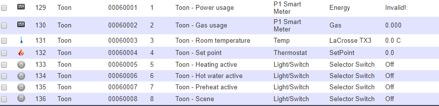

I am having some problems to get this to work. Everyting seems fine, but the devices do not show their status.
I am able the add the devices, but they do not work. After i have added the devices, the devices page stops responding. I am running the latest Beta. Am i missing something? Does someone know what is happening?

when i use
sudo pip3 install toonapilib -U
i get this message
DEPRECATION: Python 3.4 support has been deprecated. pip 19.1 will be the last one supporting it. Please upgrade your Python as Python 3.4 won't be maintained after March 2019 (cf PEP 429).
The directory '/root/.cache/pip/http' or its parent directory is not owned by the current user and the cache has been disabled. Please check the permissions and owner of that directory. If executing pip with sudo, you may want sudo's -H flag.
The directory '/root/.cache/pip' or its parent directory is not owned by the current user and caching wheels has been disabled. check the permissions and owner of that directory. If executing pip with sudo, you may want sudo's -H flag.
could this be a permission problem?

Running "sudo pip3 install -U pip" does not work for me. Maybe its time to complete reinstall domoticz.. Or does someone knows what to do when these errors occur?
