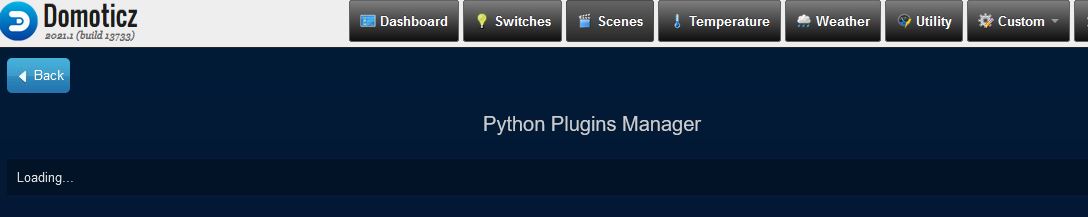

The first check I would do is to change to a default theme and check again....brianhunt wrote: Sunday 07 February 2021 14:08 Installed this and it does show a 'custom' tab. However if I go to the tab, it stays at 'loading', no plugins are showed.
Any suggestions how to solve this? (have the correct python and libraries). I use the 'Thinktheme', but don't know if that has any influence.
Thanks for your help.

Looks like a sytesheet or javascript issue.Kruu wrote: Sunday 07 February 2021 21:38 Anyone else have this problem, I do:
https://github.com/stas-demydiuk/domoti ... /issues/19
Did you do a CTRL F5 refresh?
Else delete your browser cache https://www.domoticz.com/wiki/Browser_Cache

That was the first thing I did. It did not help.waltervl wrote: Sunday 07 February 2021 21:50Looks like a sytesheet or javascript issue.Kruu wrote: Sunday 07 February 2021 21:38 Anyone else have this problem, I do:

Re: Python Plugin: Python Plugin Manager
What version of Domoticz are you running?
What browser do you use?
Try your browser in private mode.

2020.2waltervl wrote: Monday 08 February 2021 0:25 What version of Domoticz are you running?
Vivaldi, tried it in firefox and chrome also. No help if in private tab. Also have that on my mobile phone when open domoticz-devices.
Well, I just tried with a beta (2020.2.12901) and no issues with displaying on firefox and chromium. Also after the latest update of the plugin manager.
I also had no issues with stable 2020.2
I used the default theme.
So I still would advise to clear your browser cache completely

Still having the same issue. And also have that issue with zigbee2mqtt, also in devices tab, DATA column I have:
{"type": "response", "requestId": 7, "isError": false, "payload": "digraph G {\nnode[shape=record];\n \"0x00124b001ccc574e\" [style=\"bold, filled\", fillcolor=\"#e04e5d\", fontcolor=\"#ffffff\", label=\"{Coordinator|0x00124b001ccc574e (0)|0 seconds ago}\"];\n \"0x00124b00226748a5\" [style=\"rounded, dashed, filled\", fillcolor=\"#fff8ce\", fontcolor=\"#000000\", label=\"{IC Sonoff|0x00124b00226748a5 (42067)|SONOFF Motion sensor (SNZB-03)|3 hours, 22 minutes ago}\"];\n \"0x00124b00226748a5\" -> \"0x00124b001ccc574e\" [penwidth=1, weight=0, color=\"#994444\", label=\"170\"]\n}"}
