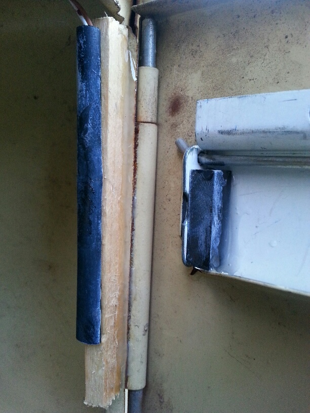

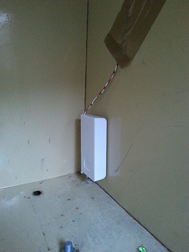

Pour terminer, voci deux photos de ma boite à lettres, le capteur le long de la porte qui assure, avec l'aimant collé sur le volet, l'ouverture de ce dernier pour les lettres et l'ouverture de la porte pour les colis.
Le boitier émetteur est situé au fond pour ne pas gêner, le fond de la boite est percé pour le passage de l'antenne. le RFXCOM 433E est situé dans le grenier d'une maison à un étage, et la liaison radio passe très bien.
Finally, here are two pictures of my mail box, the sensor along the door that ensures, with the magnet glued on the flap, opening it for letters and opening the door for parcels .
The transmission box is located at the bottom to avoid hampering the bottom of the box is pierced for the passage of the antenna. RFXCOM the 433E is located in the attic of a one-story house, and the radio link going very well.

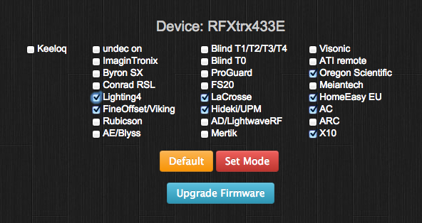

I've enabled the following protocols: I have 248 firmware on my RFXtrx433E. For me adding the sensors was very straightforward, no tricks, no hacks, they just work.khildare wrote:Hi there,
I also ordered some OUDI AD-87. But, till now I can't get them connected to Domoticz. I use a rfxcom433e with 250 (=latest) firmware.
@Jarvis: Can you explain how you got these door sensor added to Domoticz?
