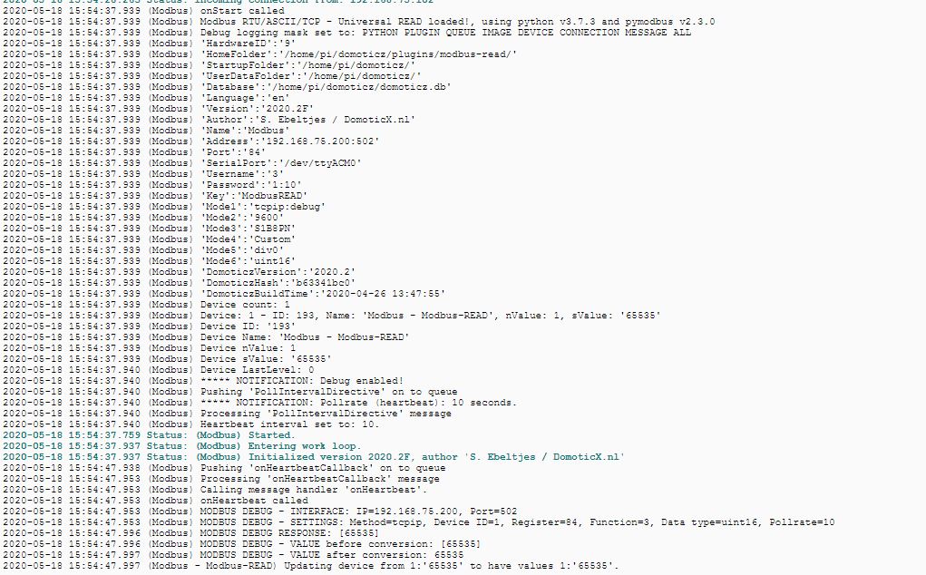

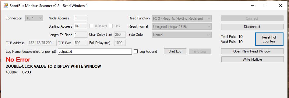

I have been digging a little further. Apparently you need to add a "/Device ID after the IP address. Maybe mention this at the setup page?
If I use a laptop with QMODMaster, I can reach the PLC via Modbus TCP. If I use domoticz, I always get this error message in the log file:
2019-10-26 09:51:40.401 Status: (Test read) Started.
2019-10-26 09:51:42.063 (Test read) onStart called
2019-10-26 09:51:42.063 (Test read) Debug logging mask set to: NONE
2019-10-26 09:51:42.063 (Test read) Sensor Type: Pressure
2019-10-26 09:51:42.065 (Test read) Modbus RTU/ASCII/TCP - Universal READ loaded.
2019-10-26 09:51:42.050 Status: (Test read) Entering work loop.
2019-10-26 09:51:42.049 Status: (Test read) Initialized version 2.0.0, author 'S. Ebeltjes / domoticx.nl'
2019-10-26 09:51:52.152 (Test read) Modbus error decoding or received no data (TCP/IP)!, check your settings!
If have set up the communication in the Hardware like this:
If I use a laptop and run a Modbus TCP Server, I can see the Modbus request from Domoticz and I can also see the reply. So apparently it got stuck on the processing of the reply in Domoticz.
I don't know how this exactly works but to me it seems that it hangs here:
What can I try/ investigate to get this thing up and running?
PLC brand is Omron with a ETN21 Modbus communication card. I have used this PLC setup for my work many times and it works very stable..
Looking forward to any reply

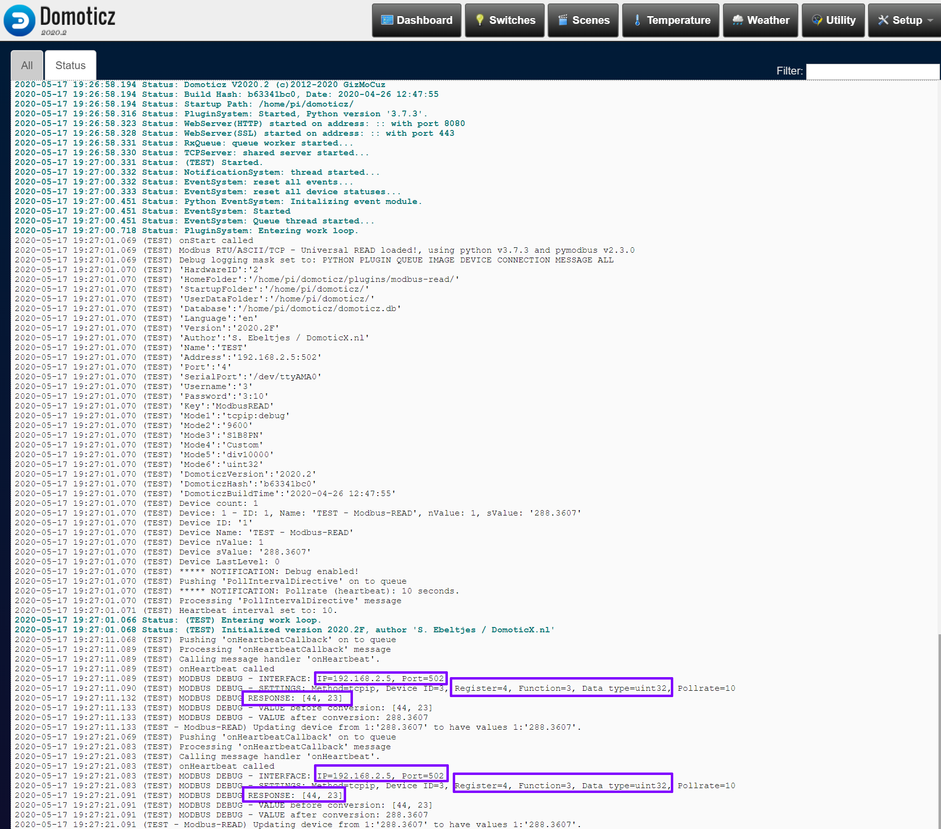

Domoticz.Debug("MODBUS DEBUG VALUE: " + str(value))
# Divide the value (decimal)?
if (Parameters["Mode5"] == "div0"): value = str(value)
if (Parameters["Mode5"] == "div10"): value = str(round(value / 10, 1))
if (Parameters["Mode5"] == "div100"): value = str(round(value / 100, 2))
if (Parameters["Mode5"] == "div1000"): value = str(round(value / 1000, 3))
if (Parameters["Mode5"] == "div10000"): value = str(round(value / 10000, 4))
if (value != "0"): Devices[1].Update(1, value) # Update value in Domoticz
except:
Domoticz.Log[b]("Modbus error decoding or received no data (TCP/IP)!, check your settings!")[/b]
Devices[1].Update(0, "0") # Update value in Domoticz

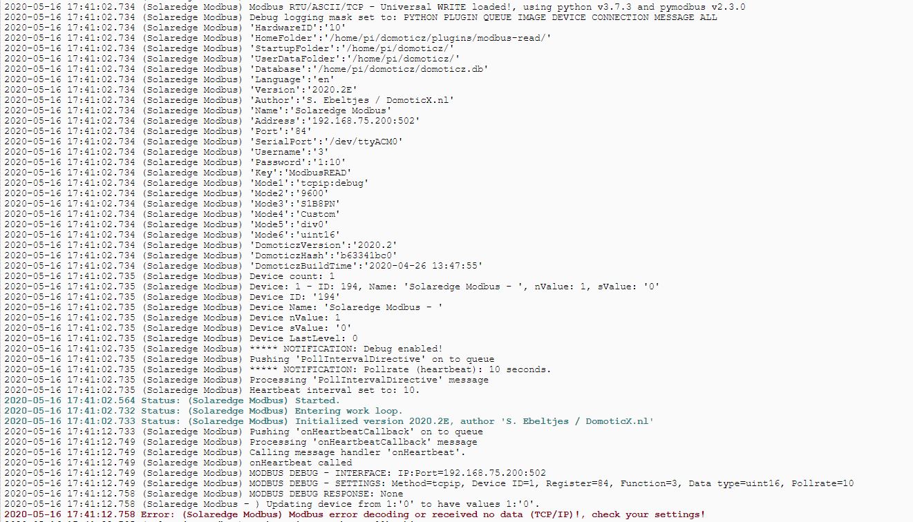

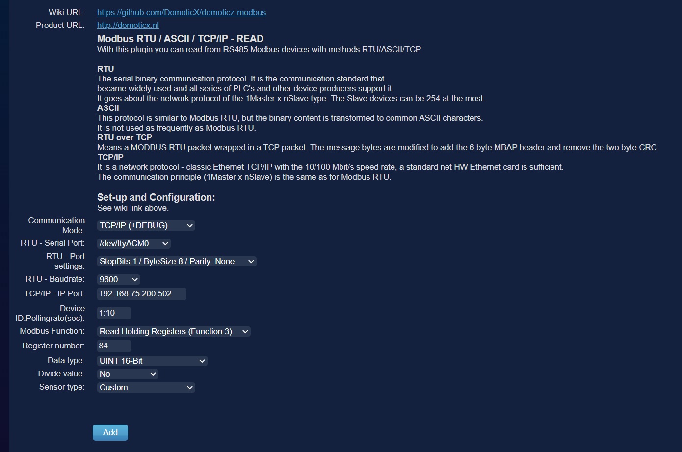

I get the error (Modbus error decoding or received no data).
When i use a modbus scanner i get a value.
What am I doing wrong

@snooze7555
Any specs on the hardware, type? manual? PDF? registers?
Ps. be aware...some solar inverters can have RS485 hw layer but it is not always modbus protocol, but some protocol the manufacturer cooked up...you have to view the manual.

Solaredge modbus TCP Sunspec Supprted inverters , when i read adress 84 int16 with ShortBus Modbus Scanner port 502. The value is ok (Kw).
https://www.solaredge.com/sites/default ... l-note.pdf
When i use the same settings then the error.

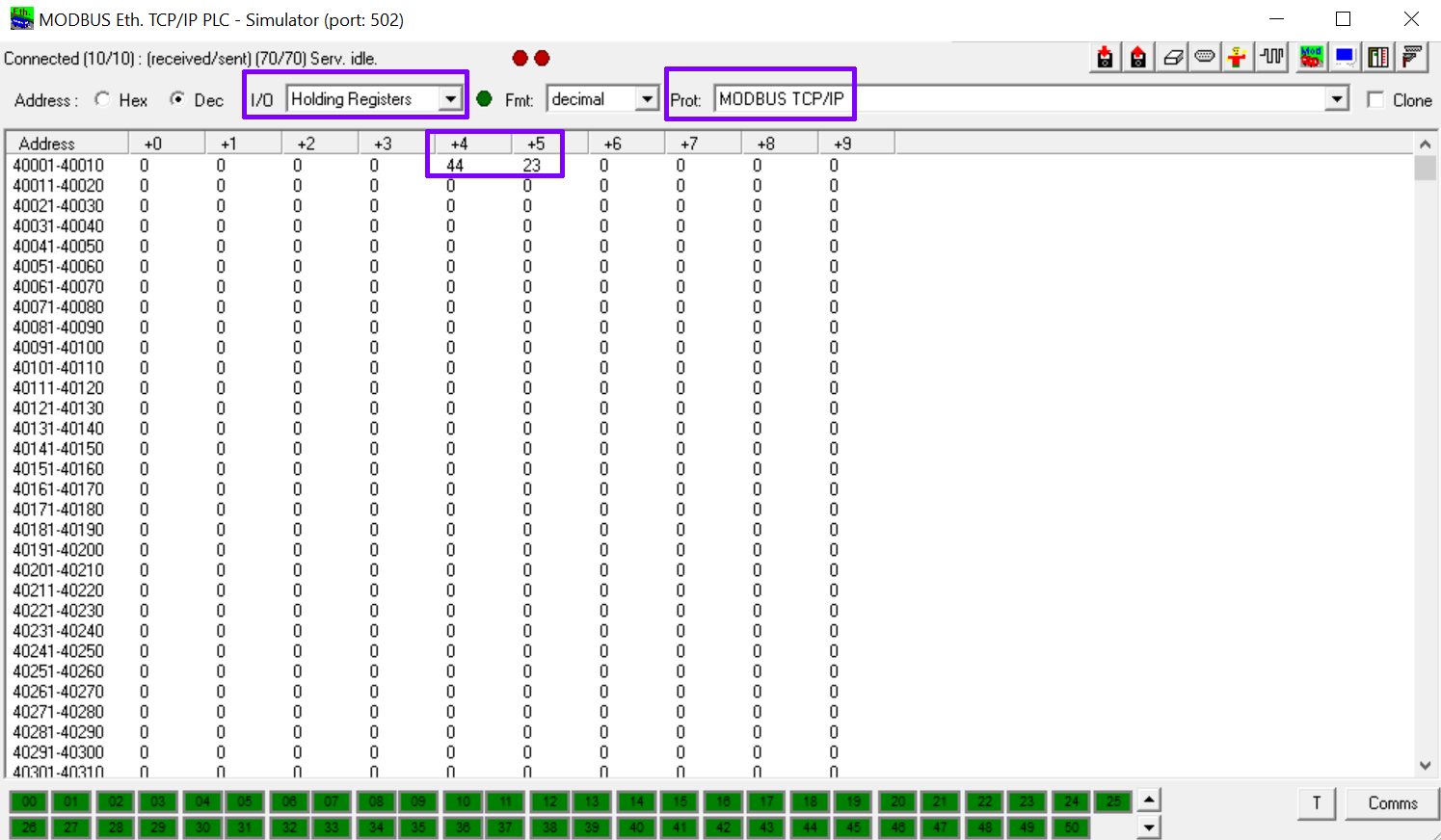

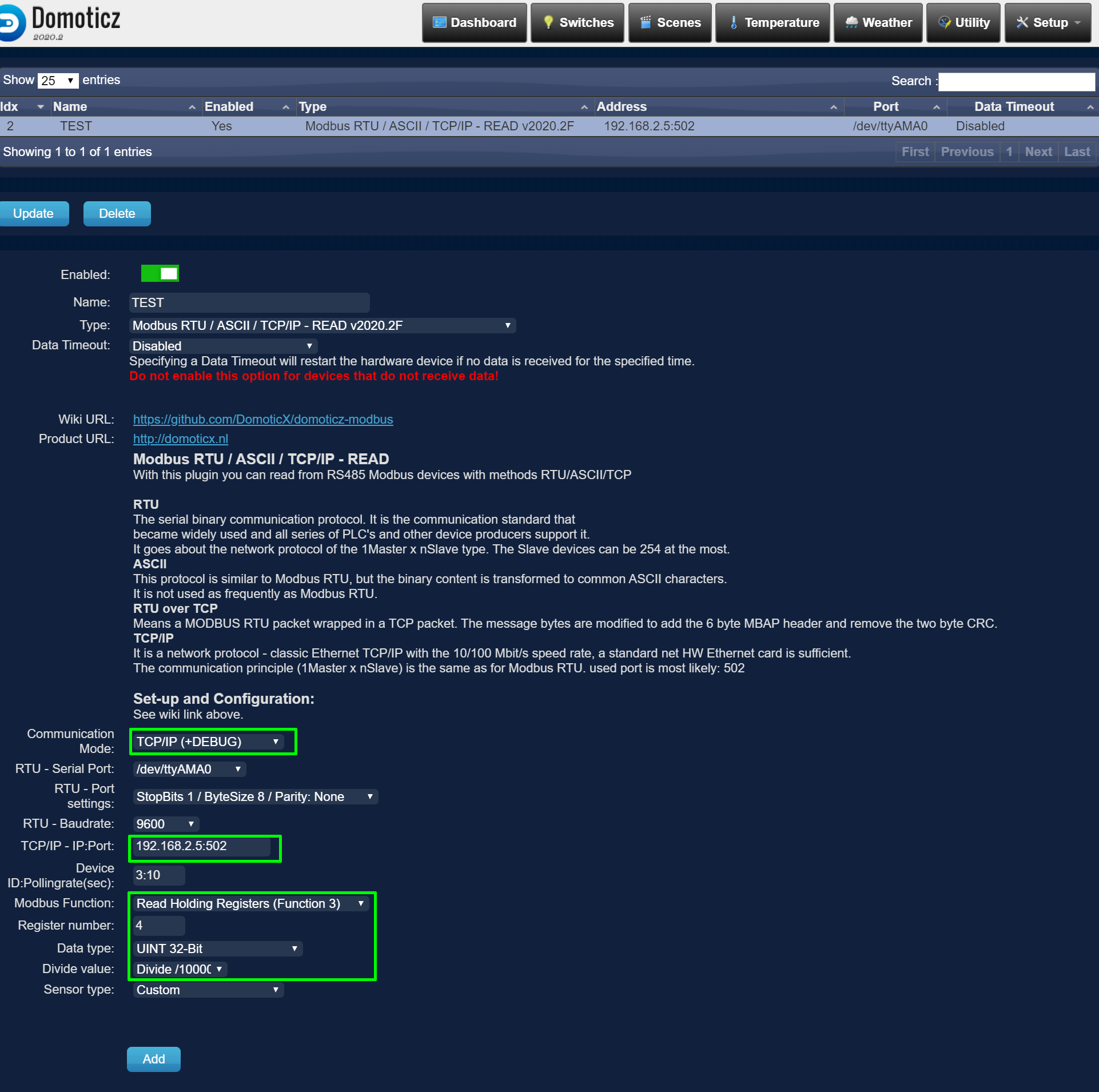

TCP/IP example
@snooze7555
In your log there is NO data response, so i did some testing @home with a TCP/IP modbus simulator, and fixed a bug...all, seems fine though...maybe you have to play with some settings...(please try latest version)
Setup the simulator Setup DomoticZ Domoticz log when read at register 4 and 5: It works...
Ps. Just updated the plugins:
Modbus WRITE v2020.2F
Fixed: Bug pymodbusTCP (TCP/IP) python plugin conversion fixed

@snooze7555
Optimized: TCP/IP port debug logging
Optimized: set default TCP/IP port to 502

Hello Domoticx
I test it with a uint 16 and get only the value 65535.
No errors
It must be 19390.
No errors
It must be 19390.

Can you post the log?snooze7555 wrote: Monday 18 May 2020 7:48 Hello Domoticx
No errors
It must be 19390.

Domoticx wrote: Monday 18 May 2020 13:11Can you post the log?snooze7555 wrote: Monday 18 May 2020 7:48 Hello Domoticx
No errors
It must be 19390.

@snooze7555,
The plugin reads "65535" wich is the actual value in the register from the device, it is read with pymodbusTCP before any data conversion done by the plugin...so no bug in the plugin atm...

snooze7555
- Posts: 8
- Joined: Saturday 16 May 2020 17:35
- Domoticz version: 2022.1
- Location: Hengelo ov /NL
Re: Python plugin: Modbus RTU / ASCII / TCP/IP
This is wat i read with the modbus scanner, that is the right value. With Domoticz 65535. Value now is 6793 >>> 679.3 WattsDomoticx wrote: Monday 18 May 2020 16:53 @snooze7555,
- Solaredge.JPG (47.33 KiB) Viewed 2995 times
