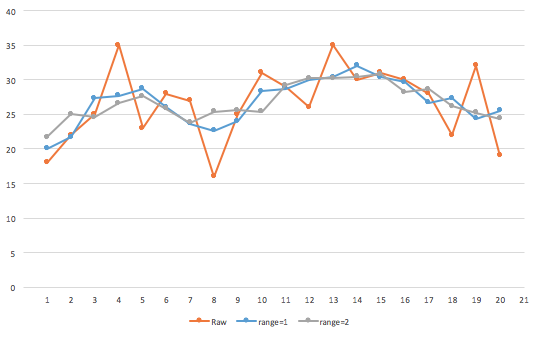

Yes, you are correct: it can even do data-smoothing which may be useful for calculating deltas or comparing data.
(The red line is the raw data with spikes, the other lines with smoothRange=1 and 2).
