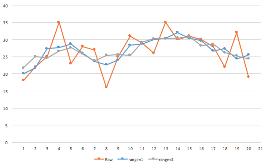

But what is even more interesting are the persistent variables defined with the type history=true flag! These variables have a time-line based internal history of previous values. You can put whatever you like in there and it acts as a FIFO queue (first in first out). So the historical set is limited in size (for performance reasons of course, fully configurable by you, see the specs). But it allows you to do really cool things like inspecting how fast a temperature rose or what the previous maximum humidity was in the past and a lot lot more:
Here is a list functions you can call on these variables:

- avg( [fromIdx], [toIdx], [default] )
- avgSince( timeAgo, default )
- delta( fromIdx, toIdx, [smoothRange], [default] )
- deltaSince( timeAgo, [smoothRange], [default] )
- get( [idx] )
- getAtTime( timeAgo )
- filter(function)
- find(function)
- forEach(function)
- getLatest( )
- getOldest( )
- localMin( [smoothRange], default )
- localMax([smoothRange], default)
- max( [fromIdx], [toIdx] )
- maxSince( timeAgo )
- min( [fromIdx], [toIdx] )
- minSince( timeAgo )
- setNew(data)
- size
- subset( [fromIdx], [toIdx] )
- subsetSince( [timeAgo] )
- reduce(function, initial)
- reset( )
- smoothItem(itemIdx, [smoothRange])
- sum( [fromIdx], [toIdx] )
- sumSince( timeAgo )
