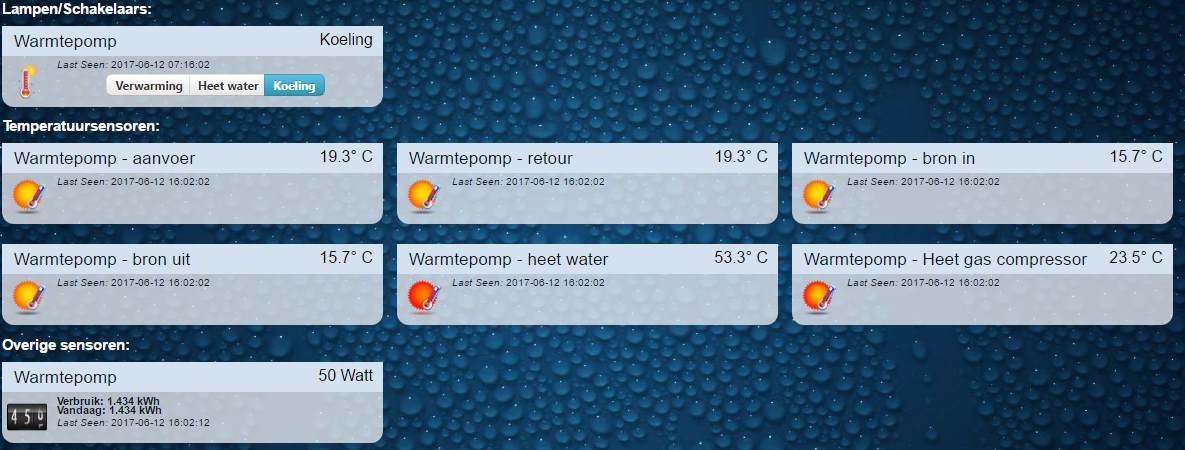

I didn't see any replies since the last couple of months
Anyway, I've got it working all the way. I didn't use the kWh anymore, since the values are not not electrical kWh's but heating, so there is a huge difference between these values and the actual electrical power consuming....
See the attachments for temperatures, which is working fine

Re: Luxtronic Heatpump controller
In hardware you can add a dummy and than add virtual sensors. If you did this you can see the virtual sensor in devices.Wiljums wrote: Friday 09 March 2018 21:08Hi, could you help to get this working in Domoticz? What should I do with this code? Snap er de ballen van..poostrom wrote: Monday 12 June 2017 16:09 Sure
#!/usr/bin/python import socket import struct import datetime import httplib ##################### # Luxtronik 2.0 IP hostHeatpump = '192.168.200.107' # Luxtronik 2.0 port (standard 8888) portHeatpump = 8888 ##################### s = socket.socket( socket.AF_INET, socket.SOCK_STREAM) s.connect( (hostHeatpump, portHeatpump)) ###################################################### s.send( struct.pack( '!i', 3004)) s.send( struct.pack( '!i', 0)) if struct.unpack( '!i', s.recv(4))[0] != 3004: print 'Error: REQ_CALCULATED CMD' exit() stat = struct.unpack( '!i', s.recv(4))[0] len = struct.unpack( '!i', s.recv(4))[0] array_calculated = [] for i in xrange(len): array_calculated.append(struct.unpack( '!i', s.recv(4))[0]) s.close () # Temp buiten conn = httplib.HTTPConnection("192.168.200.15:8080") conn.request("HEAD","/json.htm?type=command¶m=udevice&idx=924&nvalue=0&svalue=" + (str(float(array_calculated[15])/10))) # Temp aanvoer conn = httplib.HTTPConnection("192.168.200.15:8080") conn.request("HEAD","/json.htm?type=command¶m=udevice&idx=188&nvalue=0&svalue=" + (str(float(array_calculated[10])/10))) # Temp retour conn = httplib.HTTPConnection("192.168.200.15:8080") conn.request("HEAD","/json.htm?type=command¶m=udevice&idx=189&nvalue=0&svalue=" + (str(float(array_calculated[11])/10))) # Bron in conn = httplib.HTTPConnection("192.168.200.15:8080") conn.request("HEAD","/json.htm?type=command¶m=udevice&idx=190&nvalue=0&svalue=" + (str(float(array_calculated[19])/10))) #Bron uit conn = httplib.HTTPConnection("192.168.200.15:8080") conn.request("HEAD","/json.htm?type=command¶m=udevice&idx=191&nvalue=0&svalue=" + (str(float(array_calculated[20])/10))) #Heet water temperatuur conn = httplib.HTTPConnection("192.168.200.15:8080") conn.request("HEAD","/json.htm?type=command¶m=udevice&idx=200&nvalue=0&svalue=" + (str(float(array_calculated[17])/10))) #Heet gas compressor temperatuur conn = httplib.HTTPConnection("192.168.200.15:8080") conn.request("HEAD","/json.htm?type=command¶m=udevice&idx=229&nvalue=0&svalue=" + (str(float(array_calculated[14])/10))) # Lees huidige functie warmtepomp if array_calculated[119] == 1: array_calculated[119] = '0' if array_calculated[119] == 0: array_calculated[119] = '10' if array_calculated[119] == 5: array_calculated[119] = '20' if array_calculated[119] == 10: array_calculated[119] = '30' if array_calculated[119] == 15: array_calculated[119] = '30' conn = httplib.HTTPConnection("192.168.200.15:8080") conn.request("HEAD","/json.htm?type=command¶m=updateuservariable&idx=5&vname=warmtepomp_functie&vtype=uservariabletype&vvalue=" + (str(array_calculated[119])))
Every virtual sensor gets an IDX copy this and place it where I put the star *
# Temp buiten
conn.request("HEAD","/json.htm?type=command¶m=udevice&idx=924&nvalue=0&svalue=" + (str(float(array_calculated[*])/10)))
To get output from the script you can create a cron job that is running every minute.
You can send me a pm if you want.

You placed the star at the wrong position. array_calculated[*] is the place in the array being read from the luxtronik. You should leave that. You should change the udevice&idx=924 to the right device in Domoticz. So 924 should be changed to whatever ID is being used in your own virtual sensorRonker wrote: Saturday 10 March 2018 7:35In hardware you can add a dummy and than add virtual sensors. If you did this you can see the virtual sensor in devices.Wiljums wrote: Friday 09 March 2018 21:08Hi, could you help to get this working in Domoticz? What should I do with this code? Snap er de ballen van..poostrom wrote: Monday 12 June 2017 16:09 Sure
# Temp buiten
