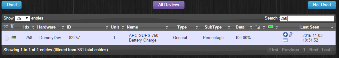

On both the new releases (latest 2.3530) the General/Percentage from a Dummy hardware and virtual sensors would not update via JSON.
The response from the JSON post was an "OK".
I reverted back to the previous stable and they are updated again.
I fetch cpu load, harddisk space and other from my Synology to be displayed via a raspberry Pi.
When I revert back to the prevoius stable I get these errors:
Error: SQL Query("SELECT ID, SceneType, ListenCmd FROM Scenes WHERE (HardwareID=2 AND DeviceID='050000' AND Unit=1 AND Type=26 AND SubType=0)") : no such column: ListenCmd
Edit:
Solved.
I reverted back and did a direct update to the latest version (2.3530) and now it works.
Edit again.
I was too optimistic. There was 1 update of the harddisk space and some others from the script, but that was only once.
Soo, the problem still exists that the virtual sensors are not updated, despite the fact that the response is an "OK"
I also have an APC UPS and those sensors are NOT updated too.
Smappee virtual sensors are updated.
Any idea's???

EddyG wrote:On both the new releases (latest 2.3530) the General/Percentage from a Dummy hardware and virtual sensors would not update via JSON.
Edit:
Solved.
Edit again.
Any idea's???

Yes, all my scripts files are present, none is deleted.
The intreging part is that some virtual devices are updated like the 2 Smappee devices.
The Smappee device are update by lua scripts.
The NONE updated devices are updated by a bash script.
They worked fine until the latest releases.
If I done it manually in the browser, instead of curl, then there is no update either, BUT I get an "OK" back from domoticz.
In the same script I also update Temperature virtual sensors, and those are update correctly.
Only the type General / Percentage are not updated.

I looked into the database, and it seems to me that the value of the previous record is copied into the new record.
The record are present but there all the same as the starting record from the last update initiated by the upgrade of Domoticz to the new version.

I think i immediately found a bug: dummy percentage devices updated through external json api calls report (when running the call) being updated, however the webinterface/device last update info and the percentage are not.
Example script output (bash -x /somescript):
+ sleep 3
++ apcaccess -p BCHARGE
++ awk '{print $1}'
+ curl -s 'http://<user:pass>@homecontrol1:8080/json.htm?type=command&param=udevice&idx=258&svalue=100.0'
   "status" : "OK",
   "title" : "Update Device"
+ sleep 240
(this should update device with IDX 258 which keeps track of the UPS battery charge level)
Webpage:
The time corresponding in the screenshot is from before the update.
The other dummy device the same script updates (load%): same issue.
Internal temperature updated through the same script works fine.
Also i have another dummy percentage device which shows the same behavior.

DaaNMaGeDDoN wrote:I think i immediately found a bug: dummy percentage devices updated through external json api calls report (when running the call) being updated, however the webinterface/device last update info and the percentage are not.
There is a solution, see: viewtopic.php?f=6&t=8701#p60362
DaaNMaGeDDoN
Posts: 55
Joined: Thursday 23 October 2014 19:01
Location: Eindhoven, the Netherlands
Re: New stable #3.521 Released today!
Post by DaaNMaGeDDoN »
EddyG wrote:...
Cheers mate, appreciated!
Now i will have to find out how to hack the database, i haven't got into that yet. Picked up pieces here and there on the subject, i'll be fine :)
Sidenote: didn't receive an email notifying me about your reply, strange.
EddyG
Posts: 1042
Post by EddyG »
Nothing to hack. Google for "SQLiteDatabaseBrowserPortable".
Stop Domoticz and copy the database "domoticz.db"
Use the program, open the database, select in browse the DeviceStatus table.
On the header set filter to the Type 243 and SubType 6
and you have all the devices.
Edit the values of the DeviceID by putting 3 zero's in front of them.
Save the database and put it back
Start Domoticz and you are done.
In a way it is a hack, because normally it should never be done like this.
DaaNMaGeDDoN
Posts: 55
@EddyG: Thanks for the instructions, but im already set; i was planning to do some more with the domoticz database anyway so i went ahead and installed&configured phpLiteAdmin.
I responded in the other thread this morning i got it fixed using your find :)
