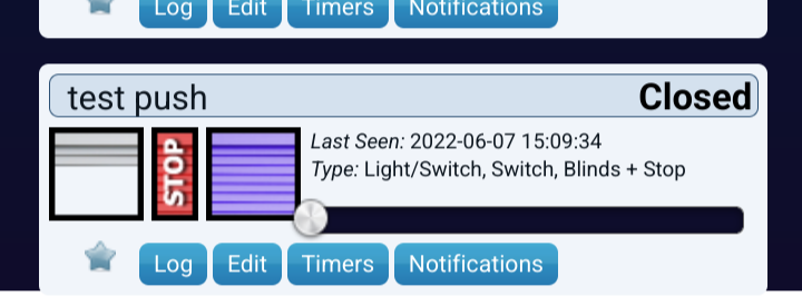

roblom wrote: Saturday 18 June 2022 11:58 Me too Image
For what reason? There is a push on or push off button that could be used as a stop button. See also

I know but it would be nice if the stop button does actually stop the blinds when you press it. It's now fully open or fully closed and nothing in between.

Stupid me did not notice the complete thread.....
But there is now a blind + stop device. It includes percentage

I know that too but still in my case it's only fully open or fully closed and no reaction on the stop button.

Then it is a different issue. It depends on your implementation how if it works. This button is created to support zwavejs2mqtt and zigbee2mqtt. Are you using those?

Ah, that makes sense because I use ozw.
