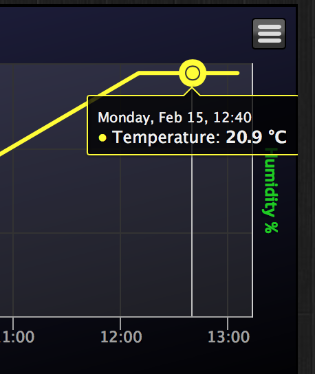

It looks like it reports only when its temperature changes by 1 degree.

Yes i though it was the 1 degree, but when i hoover over the line, it tells me on the flatline parts that it received an update every 5 minutes.
Also as you can see, i doesn't report anymore since 13:05

i had to have patience, after several hours it was working fine.
only my battery of smoke detector is almost empty after 9 months,,,, this is not ok...
Also want to increase the number of temp value per month, now i can only see min and max value for older then 24 hours
