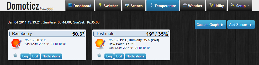

Got the Arduino Mega and Domoticz connected. The Arduino is updating a temperature and humidity sensor (Test meter) in Domoticz nicely.
The NodeJS server file

The hardware I use for the Arduino is a Arduino Mega 2560 with the Arduino Ethernetshield and a DHT11 temperature + humidity sensor. The dew point is calculated by the Arduino.
Every 10 seconds the Arduino takes a reading of the sensor and publishes that to the MQTT broker running on the RaspberryPI that also runs Domoticz. The NodeJS server is subscribed to the topic th Arduino publishes to and forwards the message to the Domoticz JSON API.
Next steps for me will be to add the code from maxtrash for de dtype etc. use instead of the idx and to finally figure out how that works and to enable two way communication.

open a new SSH window and type 'mosquitto_sub -v -t /#' to test
Example 1 (JSON, SensorType):
test: mosquitto_pub -t /actions/domoticz/xyz -m '{"SensorType":"Temperature","svalue":"21.1"}'
intended use: if you want new devices to be created in the unused tab automatically.
explanation: using a lookup table, the SensorType will be mapped to certain combination of dtype and dsubtype. I'm trying to use as much as possible the names and types as used for virtual sensors in the domoticz GUI.
Example 2 (JSON, idx-value):
test: mosquitto_pub -t /actions/domoticz/xyz -m '{"idx":247,"svalue":"21.1;70%"}'
intended use: if you (or something else) already created the sensor in Domoticz it can be referred by it's idx-number
Example 2 (JSON, did/dunit/dtype/dsubtype):
test: mosquitto_pub -t /actions/domoticz/xyz -m '{"dunit":1,"dtype":80,"dsubtype":9,"svalue":"21.1"}'
intended use: if you want to use your own dtype/dsubtype instead of the predefined ones in SensorType or dunit other than 1
(for dtype and dsubtype please refer to http://sourceforge.net/p/domoticz/code/ ... n/RFXtrx.h
e.g. 80,9 = temperature, 82,10 = temperature+humidity, 32, 1 = shuttercontact)
Example 4 (Normal, idx-value):
test: mosquitto_pub -t /actions/domoticz/247 -m 21.1
intended use: if you find JSON a bit complicated
explanation: last number in topic should be idx-number. Payload is svalue.

- start publishing your location from the android or iPhone app
- in Domoticz a rfxmeter device will be auto-discovered in the unused devices with the distance to the location in mqttitude.js (now the Eiffel Tower, but you can change this in your home location obviously).
