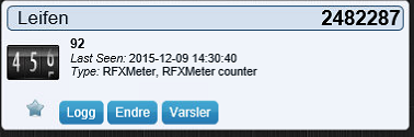

I wanted remaining km with AC off so I solved my problem by modifying Alfredos code:
But the sensor comes up with wrong numbers in the top (2482287), but the number in the middle (92) is correct.
See attached pic.
Any good ideas why?

- 2015-12-09 14_32_29-NUC - TeamViewer.png (36.64 KiB) Viewed 5366 times
Re: [609] Nissan Leaf
I'm a little busy at the moment, I'll post something updated later.
I noticed the insane amount of numbers myself and have fixed it, I'll try to integrate remaning km too, good idea.
