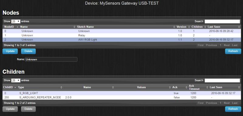

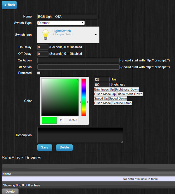

I’m trying to get the sketch from gizmocuz to work with MySensors 2.0. I have made the necessary conversion from MySensors 1.5 to 2.0. It compiles without errors.
When I upload this sketch to the Arduino Nano and run it, I see in Domoticz this:
I have made a dimmer switch in Domoticz and I see the “colorwheel”
If I run the sketch the “SendColor2AllLEDs” works. And then it stops because I don’t get any information from Domoticz to this Node. So, Domoticz is not sending commands, or it is not receiving commands.
Maybe (pretty possible) that I have overlooked something but I don’t know what.
