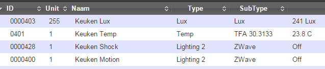

- dre68
- Posts: 27
- Joined: Friday 30 January 2015 20:18
- Domoticz version: latest
- Location: Noordwijk, Netherlands
Re: OpenZwave & Fibaro Motion Sensor
mine shows up as following
- Capture.PNG (10.23 KiB) Viewed 6793 times
roblom
- Posts: 408
- Joined: Wednesday 26 February 2014 15:28
- Location: the Netherlands
Mine are the same like dre68, only for the ID all "5" are "4", so also different ID numbers.
