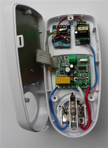

Unfortunately I am not familiar with the C compiler for the software, so I could not use the software from Sweetpants, sorry for that.
Normally I work with Arduino ide and the last couple of month I use the wemos D1 mini.
I wanted this wemos D1 mini build in in the cheap Chinese power meter and flashed with the Arduino ide.
As level shifter for the signals from the power meter print to the wemos, I used two resistors as a devider (5V -> 3.3V)
So back to the Blogspot of Kalle Hagström and make use of his routines for the power meter.
I succeededd and after all it was not a hugh problem to implement the routines.
A big advantage the solution with the wemos is 'Over The Air' (OTA) flashing and no push button(s) for flashing.

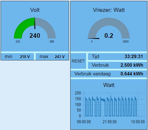

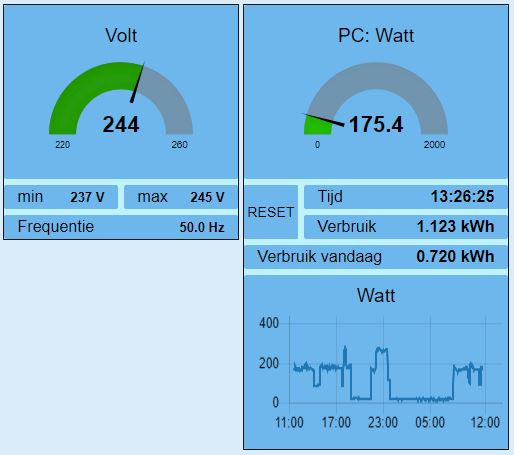

As I said before I don't use Domoticz, but I make a dashboard with Node-red.

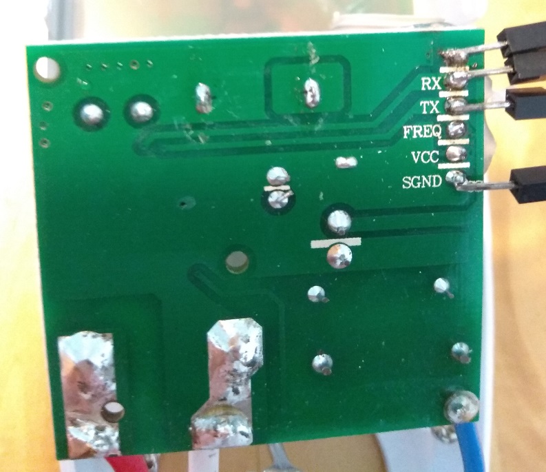

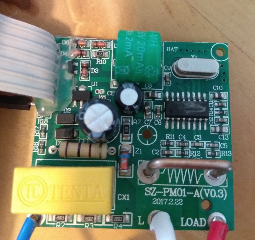

I got exited by this threat and ordered this KWH meter. However, the model I received is different inside:
As the pictures show, the pins SGND, VCC and FREQ still exist, however now there is TX, RX and an unlabeled pin. I measured the pins and the FREQ pin still outputs a 50Hz frequency, TX does outputs something and the unlabeled pin outputs 12V when the socket is connected to the grid.
The TX and RX pins indicate that it's a serial connection and therefore I connected it to a serial program. However, no commonly known baudrate outputted something useful unfortunately. I will now order a logic analyzer to understand the signal.
The PCB seems different than the older KWH-meters. I'm not sure if the IC is changed, my IC was somehow damaged so I couldn't read the text on it.

Well, after a couple of days working on this second power meter, I have it working.
The first thing I did, was to find out which chip was used.
With the help from circuitsonline https://www.circuitsonline.net/forum/vi ... 40#1914040 it turned out that it was a V9261F chip from Vango.

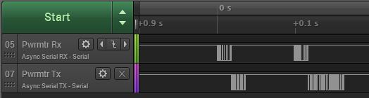

After that I found a soft serial library on Github that could be used https://github.com/plerup/espsoftwareserial
Then I did some measurements with a separation transformer and a logic analyzer.
Pwrmtr2 LA.JPG (19.96 KiB) Viewed 5391 times
What you see is the RX and TX signal every second. TX is the signal from the V9261F chip. The second burst contains the value for volt and watt.
Then I made the software with Arduino ide including mqtt for the Node-Red dashboard.
Pwrmtr2 (Small).jpg (36.05 KiB) Viewed 5391 times
Pwrmtr2 nodered.jpg (37.23 KiB) Viewed 5391 times
As a bonus I also made code for the frequency, but here in the Netherlands it is always 50.0 Hz.

SweetPants
Re: Cheap Chinese Power Meter made wireless
Post by SweetPants »
MaxwellHatcher wrote:I have a dumb question though. Why don't you take power directly off VCC of the PCB?
As said in teh first post, the on-board PSU does not deliver enough power. When transmitting, the ESP can use 200mA, way too much for this PSU
