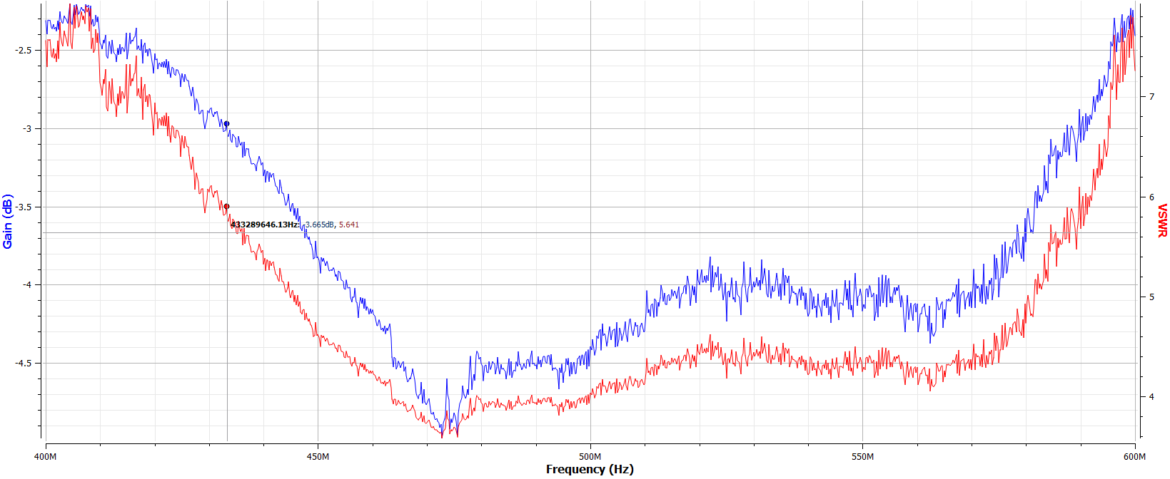

Bumping this one, always wondered about this antenna's performance. Here's an S11 measurement of the stock RFXcom antenna. Out of tune. It will work, but there's a lot of return loss and it seems to be tuned higher. SWR at 433MHz is 5.6:1 :shock:
