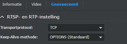

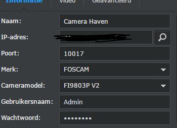

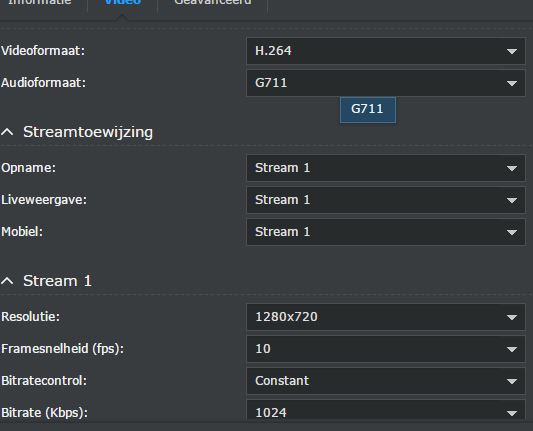

Here are my settings in SS:
General
General
Video
Video
Transport
Transport
