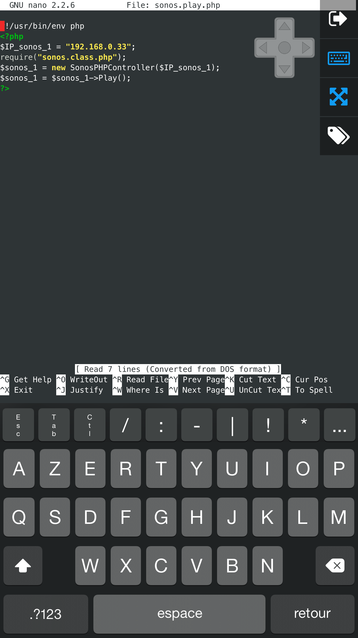

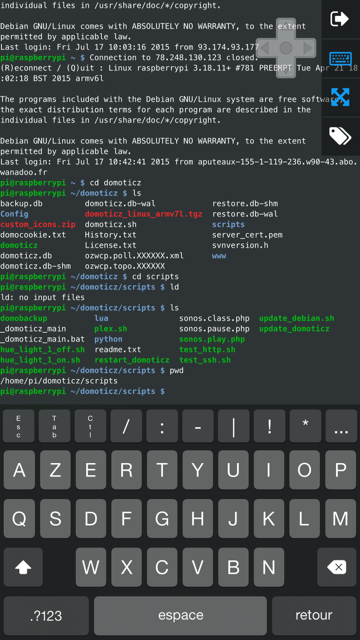

i checked the on action on the switch is :
script:///home/pi/domoticz/scripts/sonos.play.php
i joined some screenshots, it should be helpful, i hope

Not sure if that fixes it but maybe you should set the chmod u+x also on the sonos.class.php. In your screenshot you can see that it is not executable at the moment, while it is required by the sonos.play.php file.

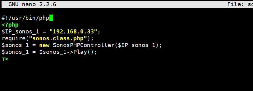

On the first line of sonos.play.php
Remove; (don't what's behind the red square). #!/usr/bin/env php
Replace by this;
#!/usr/bin/php
Replace by this;
#!/usr/bin/php
bran2000
- Posts: 60
- Joined: Saturday 20 June 2015 10:16
Re: Easy Sonos
Sorry, i already tried, it's not working
- Capture.PNG (9.54 KiB) Viewed 4233 times
