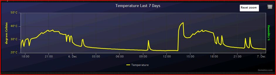

This is a typical Nefit modulation graph measured on the Out flow of the ground floor (the combination of 5 groups):
You see very long cycles of heating, and long cycles of cooling down (= heat loss).
While the room temperature goes down with 0.1C/hr.
On 6 Dec. the average outside temperature in my area was 9.5C.
If the outside temperature is around 15C, there is only one cycle in the 2 days.
Both cases give some discomfort. The room is not too cold, but the floor feels cold.
Heat request is under control of the Moduline400.
The maximum Nefit boiler temperature is limited to 40C.
The floor is consuming most of the heat so the combination of Moduline400 (heat request) and Nefit (modulation on return water) "thinks" that the best heat supply must look like this: The spikes are caused by hot water usage (remaining heat)
Even during the long cycle, the boiler maximum of 40C is not reached.
The floor is heated by water -- the floor heats the air -- the air is measured by the Moduline400 -- on request the boiler heats water -- water heats the floor.
My assumption was that this combination is not optimal in an all floor heating house.
In 1995 that was not so common. At least not for Nefit.
Thanks to Domoticz: Time for a change, see the next post.

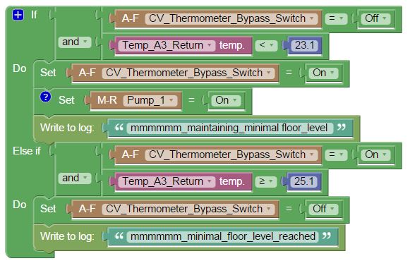

So I made a simple Blockly, to control the Thermostat_bypass.
Just an On-Off control: As soon as the floor return temperature is below 23.1C the Thermostat_bypass is switched On until a temperature higher then 25.1C.
The Pump is set to low speed (1 out of 3) just to make sure that it is running.
The normal operation of the Pump is 1 otherwise the return temperature is not representative.

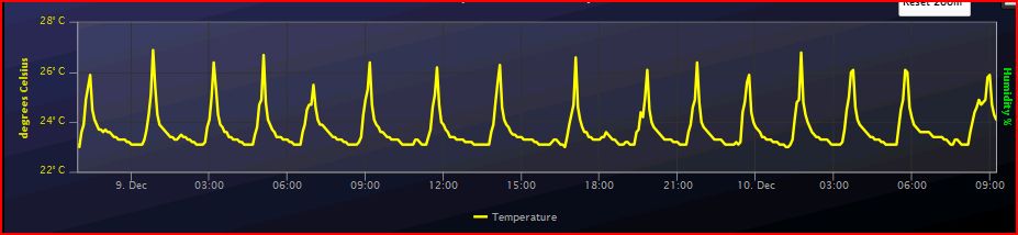

The room temerature is like this (look at the scale!) The concept is that the by-pass takes care of coarse steering while the Moduline400 is degraded to fine steering.
The current stop value in the Blockly leads to a small overheating (the slight positive trend).
I guess a 24.9 would be a good stop value to leave a small job for the Moduline400.
(an other option could be to, to insert an extra "room temperature check" in the first Blockly line)

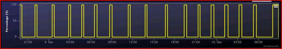

The bypass has this switch behavior:
You can see a slight duration and duty-cycle modulation

Burning cycles with 20-30 minutes duration, per cycle around 0.7m3
Repetition of around every 2 hr.

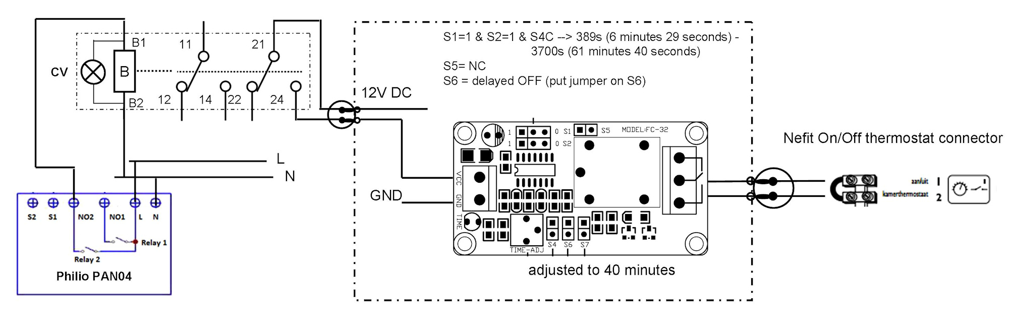

The FIBARO FGBS001 measures the outgoing floor heating water temperature.
Below 23.1C it closes the Philio PAN04-1 relay and that starts the burning cycle on 40C (the max. boiler temperature)
Why the 23.1? To show it is a Float and not Integer, Domoticz does not show the zero in 23.0 for floats (??).
If the outgoing floor heating water temperature comes above 25.1C the PAN04-1 relay opens and the burning cycle stops.
But ... when Domoticz crashes or the Node has no contact anymore, the boiler keeps on burning. That happened 2 times in the last 40 days, so I had to make it more robust.

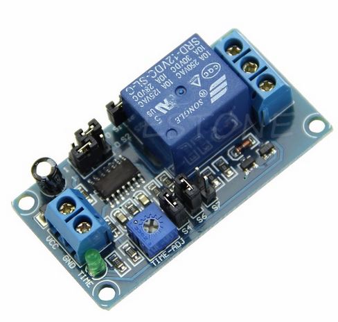

I have added in-between a delayed OFF relay to prevent cycles longer than 40 minutes (determined empirically).
For less than a whooping 3€ found here: Delay-Turn-off-Switch-Module-with-Timer-DC-12V
That leads to the following diagram: (a big picture so you can read how to adjust the relay, it comes without documentation)
In my case I had an unused contact from the Philio PAN04-1, that also controls a pump for the first-floor heating. The PAN04-1 has no "dry" contact, thats why I used a 230V relay in-between.
Alternatively the PAN06-1 has a "dry" contact, and could switch the 12V directly. Result: more comfort & less gas usage.
Hope this inspire others,

They also sell those relay boards with a better Omron relay for a similar price.Domosapiens wrote: For less than a whooping 3€ found here: Delay-Turn-off-Switch-Module-with-Timer-DC-12V
- Domosapiens
- Posts: 232
- Joined: Wednesday 20 August 2014 12:08
- Target OS: Windows
- Domoticz version: V3.5981
Re: Grundfos remote control, Nefit Ecomline, Floor heating
Thanks for the remark.
Do you have a link?
Do you have a link?
