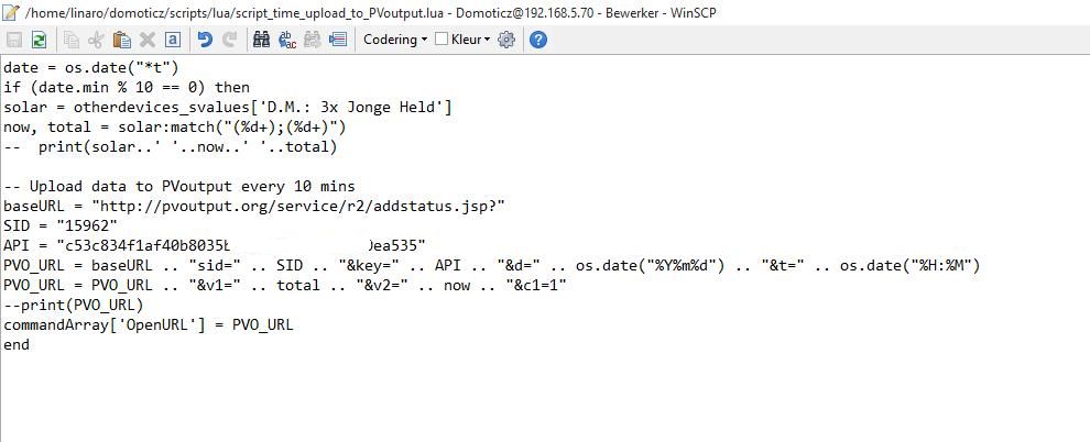

I still get every minute a error:
2016-03-21 20:43:00.357 Error: EventSystem: Lua script /home/linaro/domoticz/scripts/lua/script_time_upload_to_PVoutput.lua did not return a commandArray
I have:
What do you think i do wrong..

Sorry, I didn't publish a full script, just a snippette.
I've edited the code (above).
Make sure it's a 'time' script.

@ Wescott
Thank you very much!!!
It works!

        -- Upload data to PVoutput every 10 mins
            baseURL = "http://pvoutput.org/service/r2/addstatus.jsp?"
            SID = "<your_systemID>"
            API = "<your-api>"
            PVO_URL = baseURL .. "sid=" .. SID .. "&key=" .. API .. "&d=" .. os.date("%Y%m%d") .. "&t=" .. os.date("%H:%M")
            PVO_URL = PVO_URL .. "&v1=" .. total .. "&v2=" .. now .. "&c1=1"
            --print(PVO_URL)
            commandArray['OpenURL'] = PVO_URL
return commandArray

Try un-commenting '--print(PVO_URL)'
Let the script run, and copy the URL text from the log and run it in a browser to see what PVoutput's return status is.
You're not getting a "PVoutput.lua did not return a commandArray" error any more?

Two things -
Try printing PVO_URL and copying it to a browser to see what PVoutput returns.
print(PVO_URL)
Your SID does not look right, mine is a 5 digit number.
