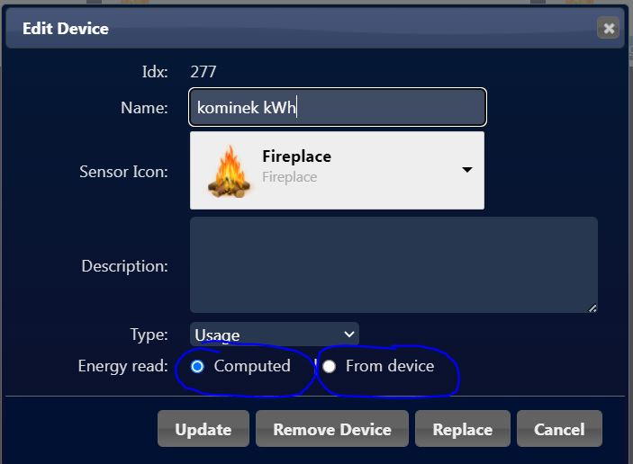

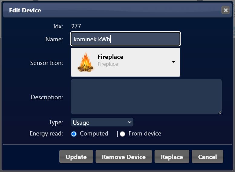

Computed or from device ?

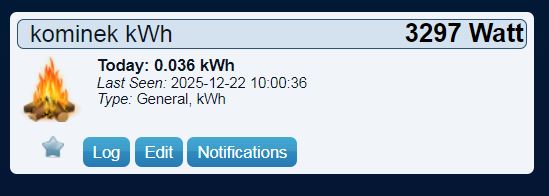

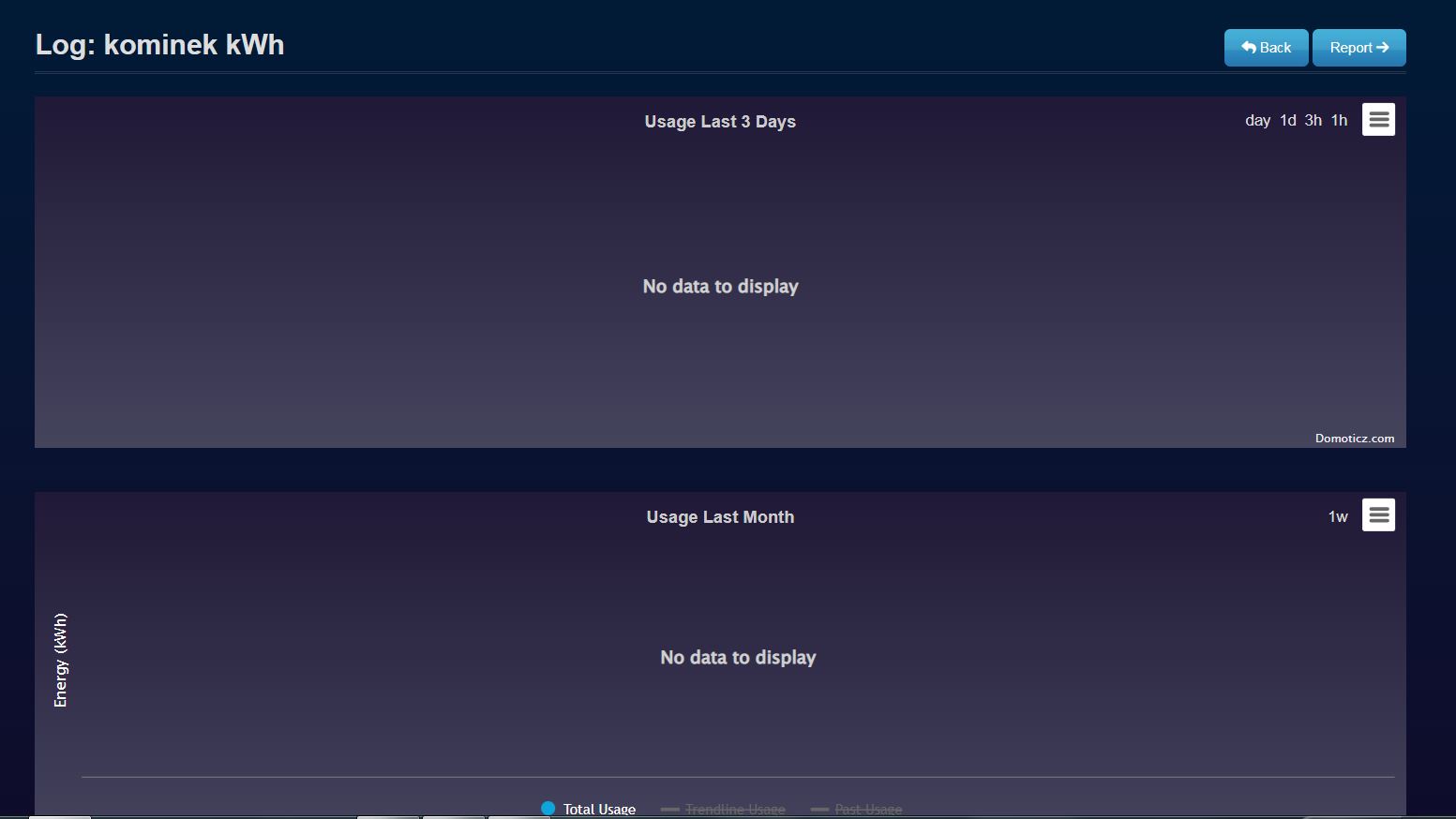

In my opinion, this device is not working. It shows the current power in watts, but does not calculate energy in kWh. There is no data in the logs.

It should be set to calculated (as you do not supply the kwh counter) and you have to supply the watt data in Watts, not kW.

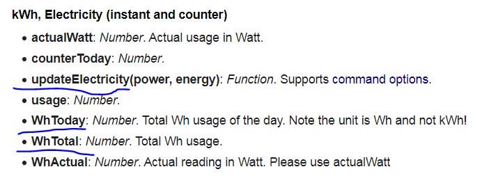

The key was writing the dz vents script:
And actually providing the device with a value in Watts.
devices = {
200
domoticz.devices(277).updateElectricity(domoticz.utils.round((domoticz.devices(252).temperature * domoticz.devices(200).flow *63.65), 0))
}- Attachments

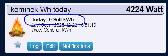

How to create a device that calculates only today Wh or total Wh ?
- b2.JPG (43.59 KiB) Viewed 3962 times
- b1.JPG (27.34 KiB) Viewed 3962 times
BartSr
- Posts: 541
- Joined: Sunday 03 July 2016 16:16
- Domoticz version: V2024.7
Re: Domoticz thermal energy kWh, thermal energy meter
This device automaticly resets the daily usage to 0 at 00.00h

Ok, but I want to display today wh and total wh on the display. How to do it?
- Posts: 7019
- Domoticz version: 2026.3
You cannot do that, there is no option for that. The whtotal value is only available on the log-report page of the device.
