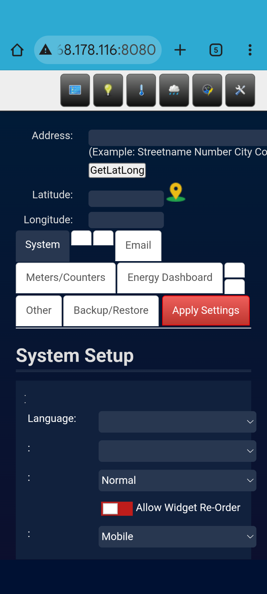

I just installed the lastest build 17036 of Domoticz on my test Raspberry Pi 3B (without z-wave stick) with 32 bit bookworm.
Info: https://github.com/domoticz/domoticz/issues/6508
Open z-wave is back in the hardware settings.
But now my System Setup Menu is messed up, with a lot of empty fields:

Did you clear your browser cache or use a private/incognito browser session?
Edit: never mind. I have this too, it is probably not related to the OpenZwave but google notifications settings change.
I made a separate github issue for this.

Settings is fixed in latest beta. Thanks for spotting!
