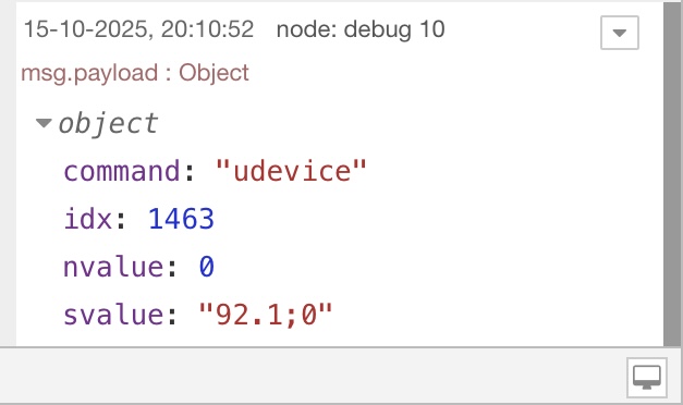

Can you tell me, what you see in "debug 10", both with my Inject node and with the Tuya device?

First one with inject node:Image
Second one with tuya node:Image
And still errors in the log:

I am puzzled. There is no difference between the real Tuya device and the simulation. The values and the formatting of the Object is correct.
