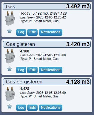

Here is the result of my programming.

Posts: 7006
Domoticz version: 2026.3
Re: DzVents script suggestions please
I personally would have put these extra values yesterday and day before yesterday in a custom sensor device for easier display https://www.domoticz.com/wiki/Dummy_for ... tom_Sensor

waltervl wrote: Tuesday 05 December 2023 13:59 I personally would have put these extra values yesterday and day before yesterday in a custom sensor device for easier display https://www.domoticz.com/wiki/Dummy_for ... tom_Sensor
You're right @waltervl, the tile has a more tidy look.
Which raises the next question.
Where or how can I find the gasmeter icon to add that to the CustomSensor.
In general: I'd like to have the full choice of preloaded Domoticz icons for every type of tile.
Is that possible for a next version (2024.1) or can it be achieved with some kind of trick in the current version.
Bugs bug me.

You are not able to change the icon to a Gas meter with the edit button?

waltervl wrote: Thursday 07 December 2023 17:40 You are not able to change the icon to a Gas meter with the edit button?
Not for a Custom sensor. The gas choice dormant pop up.

Indeed, I tested it in latest beta and no gas meter icon available for custom sensor.
