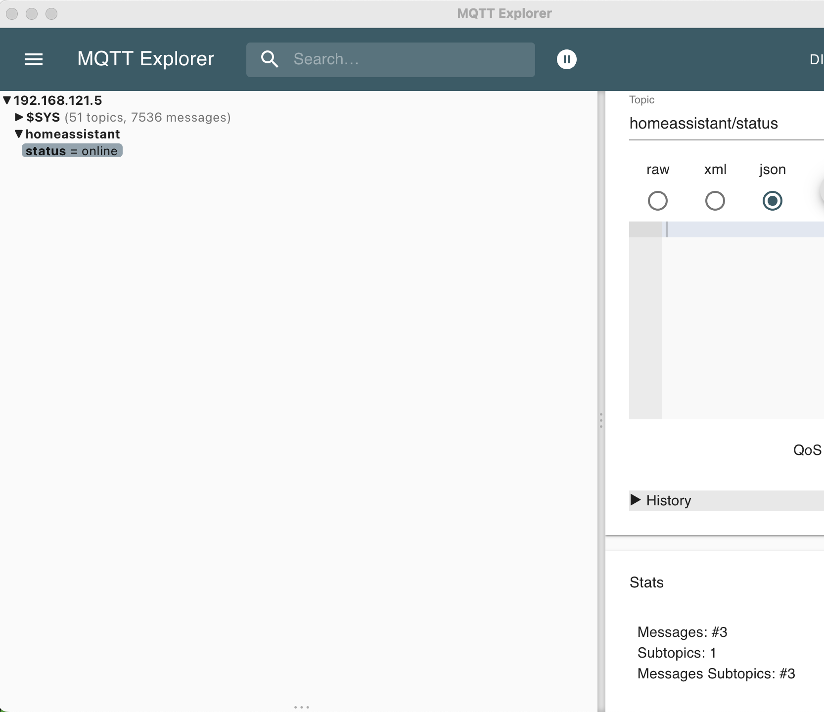

All I am seeing...
Screenshot 2024-01-05 at 13.10.46.png (147.94 KiB) Viewed 11737 times
Posts: 6681
Domoticz version: 2025.1
Re: No device listed under "Setup" on MQTT Auto Discovery
Something wrong with Zwave-JS-UI.....

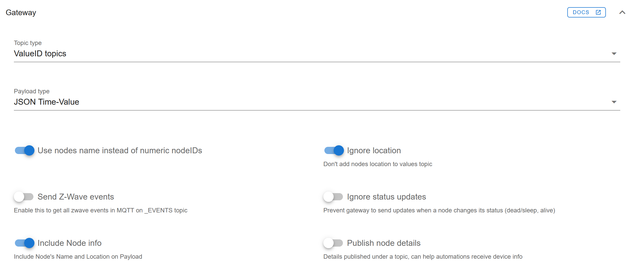

Have the same issue that nothing is showing up under the Hardwar Setup button, just a reflection, which I haven't tried to change, but according to the recommendation for how to config Zwave-JS-UI is to ues node name instead of nodeIDs which very well could be the cause.
Update: Allow my to respond myself to this that it didn't make any difference to disable the use of node name instead of node IDs.
