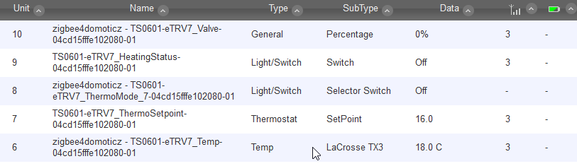

Nice! it is recognized now, and 5 devices are added in domoticz:
TS0601-eTRV7_Valve-04cd15fffe102080-01
TS0601-eTRV7_HeatingStatus-04cd15fffe102080-01
TS0601-eTRV7_ThermoMode_7-04cd15fffe102080-01
TS0601-eTRV7_ThermoSetpoint-04cd15fffe102080-01
TS0601-eTRV7_Temp-04cd15fffe102080-01
2023-03-17 15_43_37-Clipboard.png (16.51 KiB) Viewed 1139 times
The temperature is working, the setpoint can be entered in domoticz, but is not changing in the TRV.

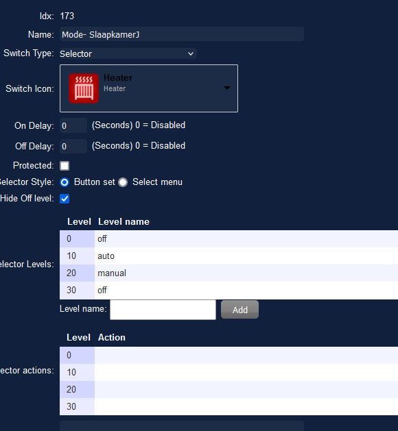

tuya thermomode.png (22.87 KiB) Viewed 1130 times

I have included a screenshot from the tinytuya thermomode settings, maybe that helps.

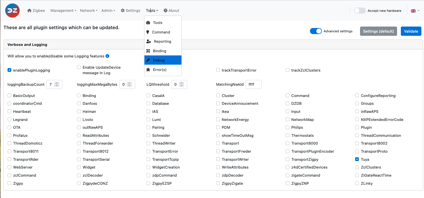

I also found that debug Tuya seems not set, could please set it ?
Screenshot 2023-03-18 at 09.44.52.png (171.55 KiB) Viewed 1079 times

ok will do. I did set tuya debug.. we'll see this time
Re: Another Zigbee TRV (TS0601)
Posted: Saturday 18 March 2023 10:49
by hyeronimo
Ah. I get it .. the validate button is needed to save the settings from the debug page.

I noticed the thermomode looks a bit different then the one I had from tinytuya. The extra off setting and 'hide off tickbox' are not there.
