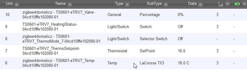

Nice! it is recognized now, and 5 devices are added in domoticz:
TS0601-eTRV7_Valve-04cd15fffe102080-01
TS0601-eTRV7_HeatingStatus-04cd15fffe102080-01
TS0601-eTRV7_ThermoMode_7-04cd15fffe102080-01
TS0601-eTRV7_ThermoSetpoint-04cd15fffe102080-01
TS0601-eTRV7_Temp-04cd15fffe102080-01 The temperature is working, the setpoint can be entered in domoticz, but is not changing in the TRV.
The tinytuya version had a switch which gave the options auto/manual/off where auto was used for the timer programs. Two other switches from tinytuya were Child lock (on/off) and Window Check (on/off)
Here is the log.

Changing the setpoint on the TRV does change the value in domoticz correctly
Also the Valve % open changes, but 26 degrees makes the valve% move to 680%
Heatingstatus in domoticz changed to 'on'
Thermomode remains 'off'
Changing it back to 10 degrees (=lower than the current room temp), Domoticz reports 10 degrees setpoint
the Valve % open changes to 0% again
Heatingstatus in domoticz changed to 'off'

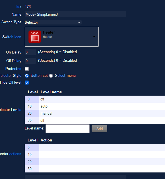

I have included a screenshot from the tinytuya thermomode settings, maybe that helps.

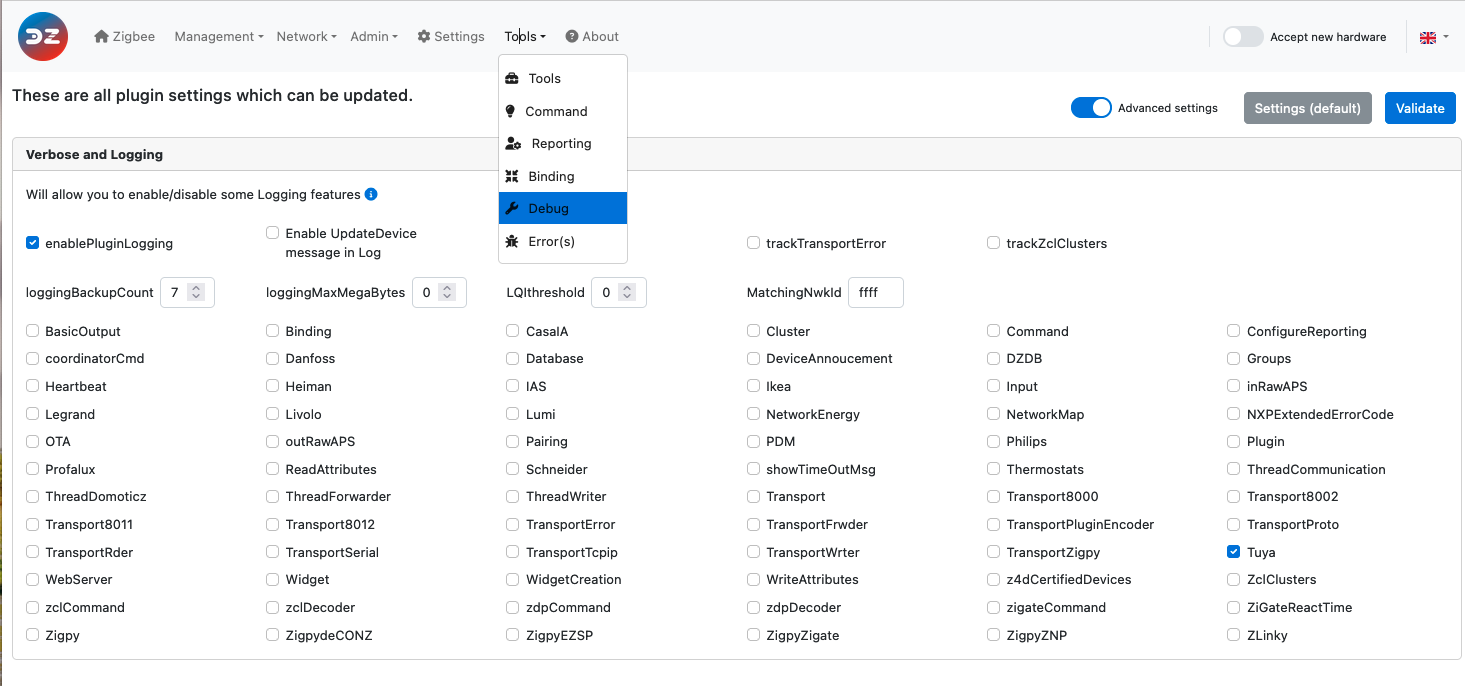

Re: Another Zigbee TRV (TS0601)
please try again I fixed some stuff
(1) update plugin
(2) remove ALL widgets (I'm afraid that the ThermoMode was not removed)
(3) restart the plugin and check that thde device is not listed anymore in the plugin
(4) redo the pairing
I also found that debug Tuya seems not set, could please set it ?

ok will do. I did set tuya debug.. we'll see this time
hyeronimo
- Posts: 68
- Joined: Saturday 11 March 2023 8:33
Ah. I get it .. the validate button is needed to save the settings from the debug page.

I noticed the thermomode looks a bit different then the one I had from tinytuya. The extra off setting and 'hide off tickbox' are not there.

For each change in the Device System Mode, you should see in the log this message with a different value for SystemMode.
git pullFor each change in the Device System Mode, you should see in the log this message with a different value for SystemMode.
I need to understand what is the value for Off, Auto ...s0601_trv7_system_mode - After Nwkid: 7564/01 SystemMode: 1
