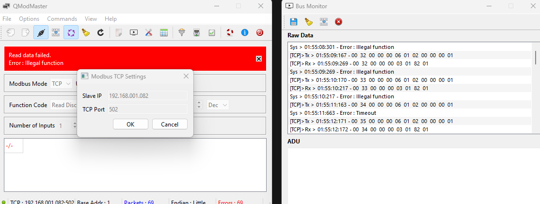

Changed the IP to: 192.168.1.82 Port: 502
Seems that the Port is open: see the screenshot Hope someone could help?

sudo systemctl restart domoticzSeems that the Port is open: see the screenshot Hope someone could help?

It seems the main library is python >= 3.10 You are on 3.7 so it could not work.

Hello Waltervl!!waltervl wrote: Monday 21 July 2025 8:22 It seems the main library is python >= 3.10 You are on 3.7 so it could not work.
https://github.com/wlcrs/huawei-solar-lib
Thanks for your help!!! I think that solves the problem too.
