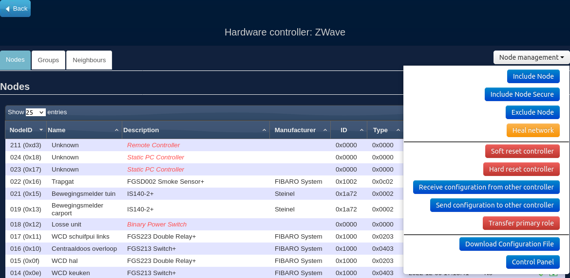

In the screenshot there are a 'receive configuration...' and a 'send configuration... '. This is how I 'cloned'. When I plug in the 'cloned' stick it shows up as a 'Static PC controller' as you can see in the screenshot. So I guess that they have different ID's. My setup is similar to yours 1 controller with OZW and the other on another machine with Zwave-JS-UI and on that test machine only 2 (of 21) nodes get somewhat regularly updated and the rest is not updated. Don't know if your backup tool will work because I have 2 z-wave.me sticks.

'send configuration and 'receive configuration 'in OZW CP are not suited for backup. These functions are used to switch the role between several controllers in a same network. As far as I know OZW does not support stick backup.

Son brought back the Windows laptop and I could copy my 'live' Z-wave stick to the 'spare' Z-wave stick. That made all the difference! Thx @mgugu.
