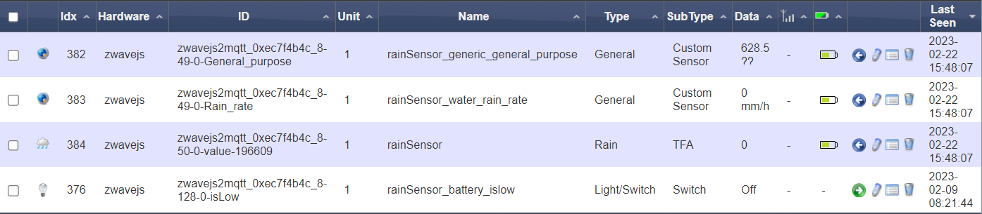

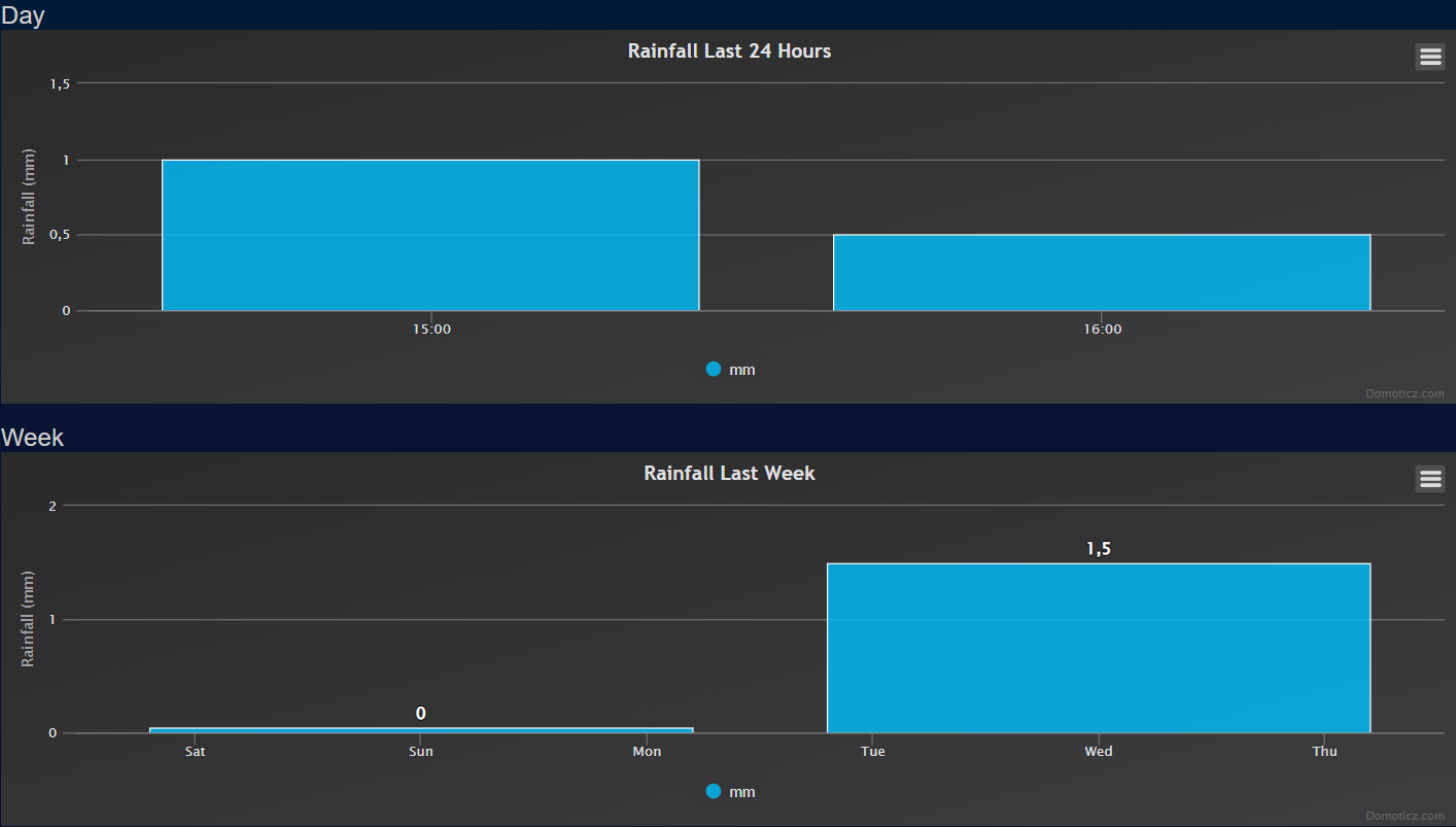

Rain was there yesterday, here is complete reporting:
Discovery mqtt config messages: see viewtopic.php?p=284769#p284769
Discovery domoticz log messages:
Update mqtt messages:
Conclusion:
1- Battery level correctly reported
2- Counter unit not set: 3- Wrong raindata (mm) reported: The log reports 1.5mm for last wednesday but it should be 2.5mm according to updates record:
Before "2023/02/22 14:30:13": 626 mm
Latest value at "2023/02/22 15:48:07" : 628.5 mm
2023-02-09 08:21:43.119 Status: zwavejs: discovered: rainSensor/rainSensor_generic_general_purpose (unique_id: zwavejs2mqtt_0xec7f4b4c_8-49-0-General_purpose)
2023-02-09 08:21:43.221 Status: zwavejs: discovered: rainSensor/rainSensor_water_rain_rate (unique_id: zwavejs2mqtt_0xec7f4b4c_8-49-0-Rain_rate)
2023-02-09 08:21:43.324 Status: zwavejs: discovered: rainSensor/rainSensor_water_cubic_meters_value (unique_id: zwavejs2mqtt_0xec7f4b4c_8-50-0-value-196609)
2023-02-09 08:21:43.427 Status: zwavejs: discovered: rainSensor/rainSensor_battery_level (unique_id: zwavejs2mqtt_0xec7f4b4c_8-128-0-level)
2023-02-09 08:21:44.967 Status: zwavejs: discovered: rainSensor/rainSensor_battery_islow (unique_id: zwavejs2mqtt_0xec7f4b4c_8-128-0-isLow)
