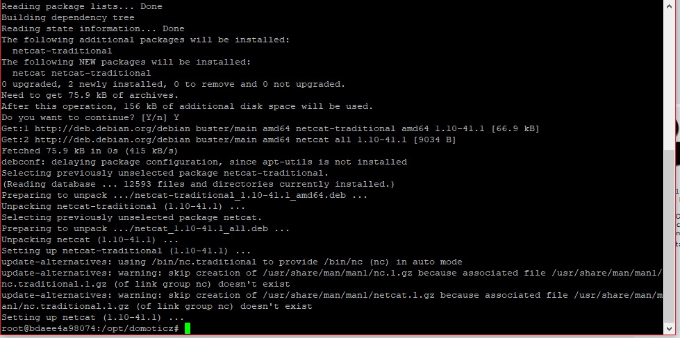

That is probably because the 'nc' command is not in the docker image.
You could install that but remember that every time you update the image you will have to do it again, because it is lost if you update the image.
Go into the container with
execute these command in the container.
exit the container.
sudo docker run -it domoticz/domoticz /bin/bashCode: Select all
apt-get update
apt-get install netcat- fabry91

I have tried to install netcut but it returns with some warnings, same error in Domoticz when I run the script:EddyG wrote: Wednesday 05 January 2022 16:26 That is probably because the 'nc' command is not in the docker image.
Go into the container withexecute these command in the container.Code: Select all
sudo docker run -it domoticz/domoticz /bin/bashexit the container.Code: Select all
apt-get update apt-get install netcat

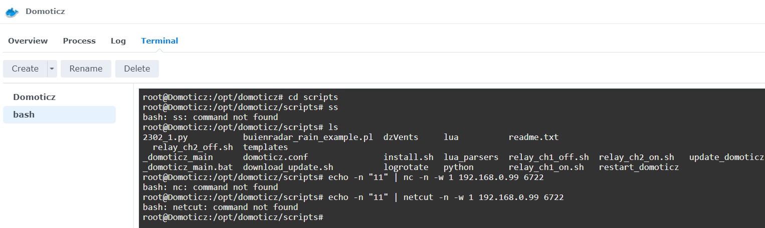

PS. the script is:
echo -n "11" | nc -n -w 1 192.168.0.99 6722- Attachments

Re: Synology - script doesn't work
Try using netcat instead of the nc command in the script.
echo -n "11" | netcat -n -w 1 192.168.0.99 6722- fabry91

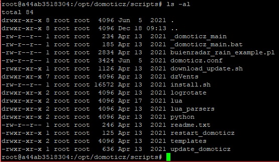

same error, I noticed that in the container scripts folder there isn't the same script files outside the docker:EddyG wrote: Wednesday 05 January 2022 16:57 Try using netcat instead of the nc command in the script.Code: Select all
PS. I have modified the scripts file in "\docker\Domoticz\scripts"
- scripts.jpg (107.8 KiB) Viewed 47225 times

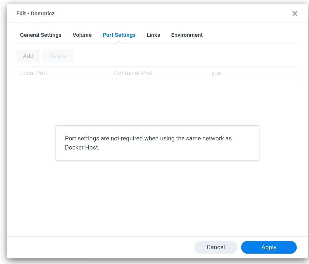

Okay, port settings of the docker says that is in the same network of the docker host, how can I open port 6722?EddyG wrote: Wednesday 05 January 2022 21:50 I oversaw that you have to open port 6722 in the docker container besides the port 8080 and 443
Did you test the complete command on the command line in the docker container?
- Screenshot_20220105-222521__01.jpg (55.95 KiB) Viewed 47185 times
Set the problem of the port aside, it does not hurt, I assumed that the same port might be used for a response.
First get your script working from inside docker.
Did you try to execute the script content inside the docker container?
Did you try to find inside the container your script?
E.g. in /opt/domoticz/scripts or /opt/domoticz/userdata or /opt/domoticz/userdata/scripts
And what is the result?
If you found your script in the docker container, did you try to execute the script from inside the container?

So I tried to execute the script from a command line inside the docker and the result is "command not found":
- scripts.jpg (139.46 KiB) Viewed 47142 times
That is really strange. I did the same on my test system where domoticz also runs in a container.
I got the same errors when installing netcat.
Both nc and netcat are found in /bin/ in the docker container.
Your echo -n "11" | nc -n -w 1 192.168.0.99 6722 command runs fine in my container, of course I get an error about the non-existing IP or with a real IP that connection is refused.
You can check if those nc and netcat commands exists in the /bin/ directory in the container.
Remember (like I said before) when ever you stop the container or update the image the 2 command to install netcat have to be run again.
'netcat' is NOT part of the image. That is 1 of the disadvantages of running Domoticz in a docker container.
If you do have anything special (like you have with netcat / nc) than Domoticz in a container might not be a good idea.
