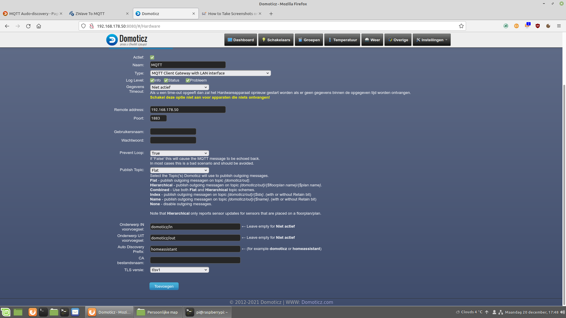

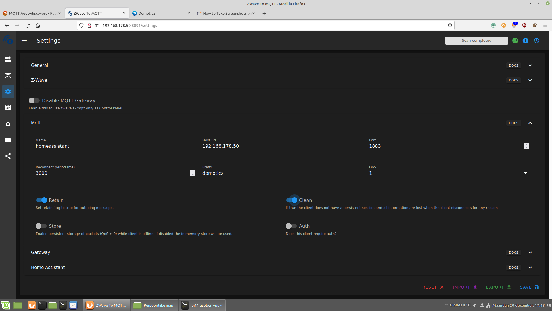

Still the same error
Schermafdruk van 2021-12-20 17-48-00.png (128.4 KiB) Viewed 3701 times
Schermafdruk van 2021-12-20 17-48-26.png (202.74 KiB) Viewed 3701 times
 2021-12-20 17:47:14.732 Error: MQTT: MQTT_Discovery: Something other then 'config' received on discovery topic! (18/38/0/currentValue/{"time":1640003037730,"value":99,"nodeName":"Wasmachine","nodeLocation":"Zolder"})!
2021-12-20 17:47:14.732 Error: MQTT: MQTT_Discovery: Invalid/Unhandled data received! (Topic: 18/38/0/currentValue, Message: {"time":1640003037730,"value":99,"nodeName":"Wasmachine","nodeLocation":"Zolder"})
2021-12-20 17:47:14.732 Error: MQTT: MQTT_Discovery: Something other then 'config' received on discovery topic! (23/38/1/currentValue/{"time":1639954365610,"value":0,"nodeName":"Kamer dimmer","nodeLocation":"Huiskamer"})!
2021-12-20 17:47:14.732 Error: MQTT: MQTT_Discovery: Invalid/Unhandled data received! (Topic: 23/38/1/currentValue, Message: {"time":1639954365610,"value":0,"nodeName":"Kamer dimmer","nodeLocation":"Huiskamer"})
2021-12-20 17:47:14.732 Error: MQTT: MQTT_Discovery: Something other then 'config' received on discovery topic! (23/38/2/currentValue/{"time":1639821438142,"value":99,"nodeName":"Kamer dimmer","nodeLocation":"Huiskamer"})!
2021-12-20 17:47:14.732 Error: MQTT: MQTT_Discovery: Invalid/Unhandled data received! (Topic: 23/38/2/currentValue, Message: {"time":1639821438142,"value":99,"nodeName":"Kamer dimmer","nodeLocation":"Huiskamer"})

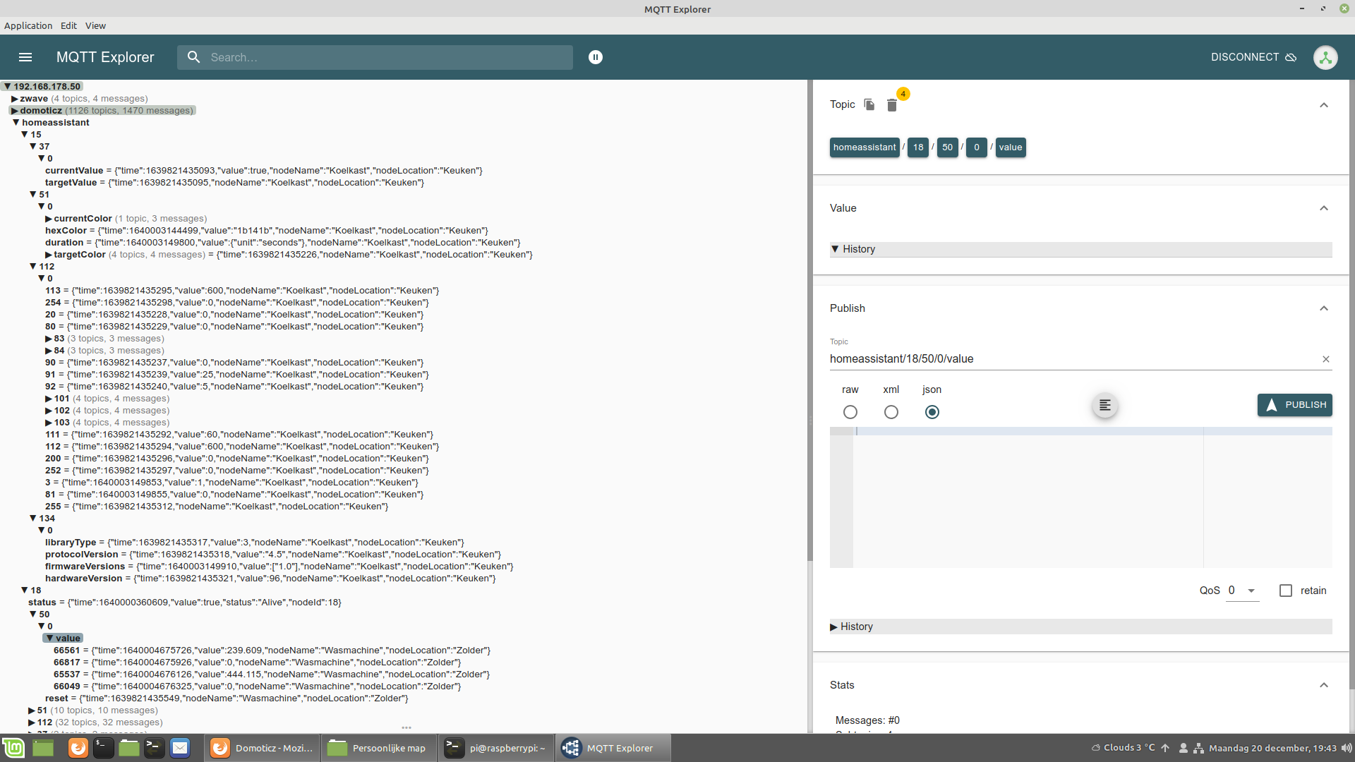

I cannot see any config message in MQTT explorer.
Schermafdruk van 2021-12-20 19-43-24.png (277.43 KiB) Viewed 3685 times

If this is your zwavejs config then that still uses domoticz as the prefix instead of homeassistant. Looks like you changed the name, not the prefix (on the second line).

You really need to get rid of all those homeassistant topic message as they all seem to be status update messages which should not be the case. They should be standard in the ZWAVE topic. Did you change that default too?
Also check your domoticz topic for any retained messages from the ZWAVEJS2MQTT gateway and get rid of those too.
Review your ZWAVEJS2MQTT and set the discovery topic to homeassistant and set the status update topic to zwave and ensure this config becomes active.
After that you should see the config payload in MQTTExplorer.
EDIT: Just checked the ZWAVEJS2MQTT settings and these need to be checked (these are the defaults as far as I remember):

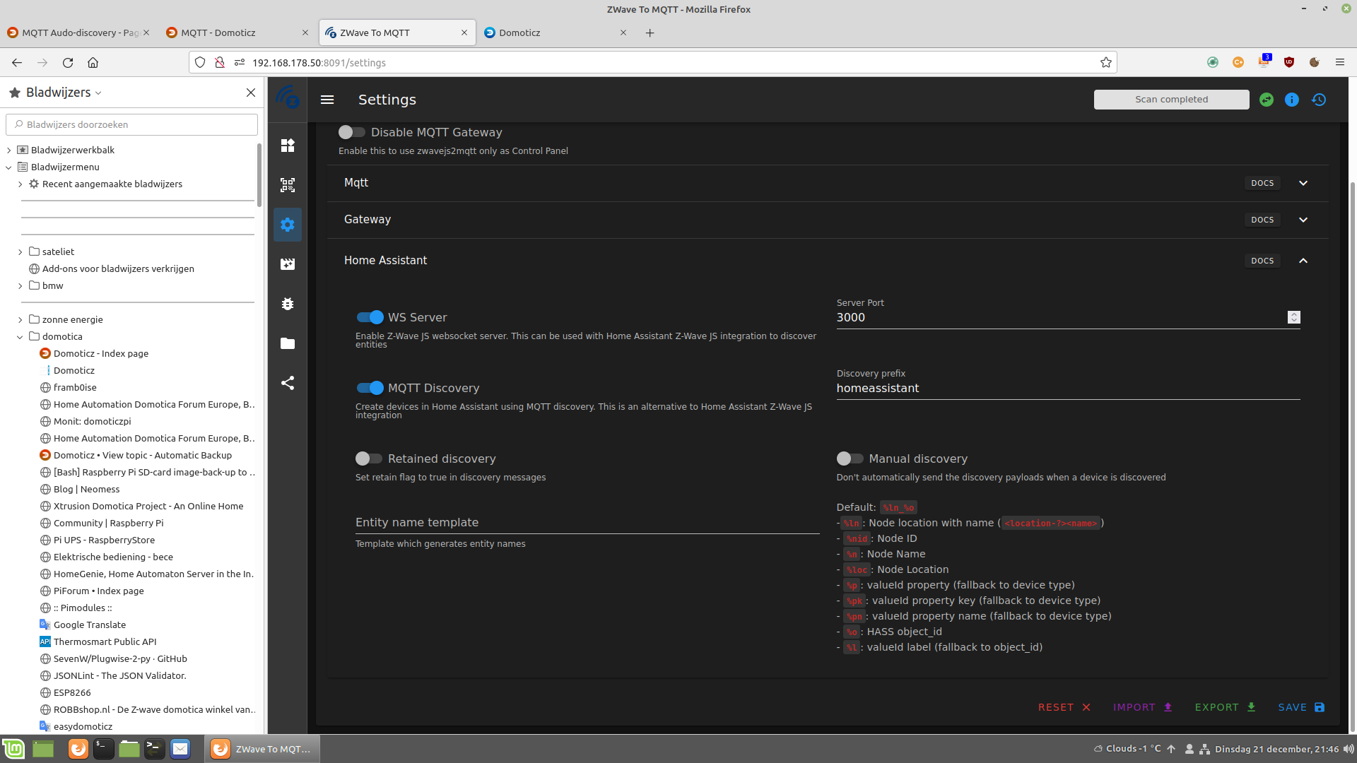

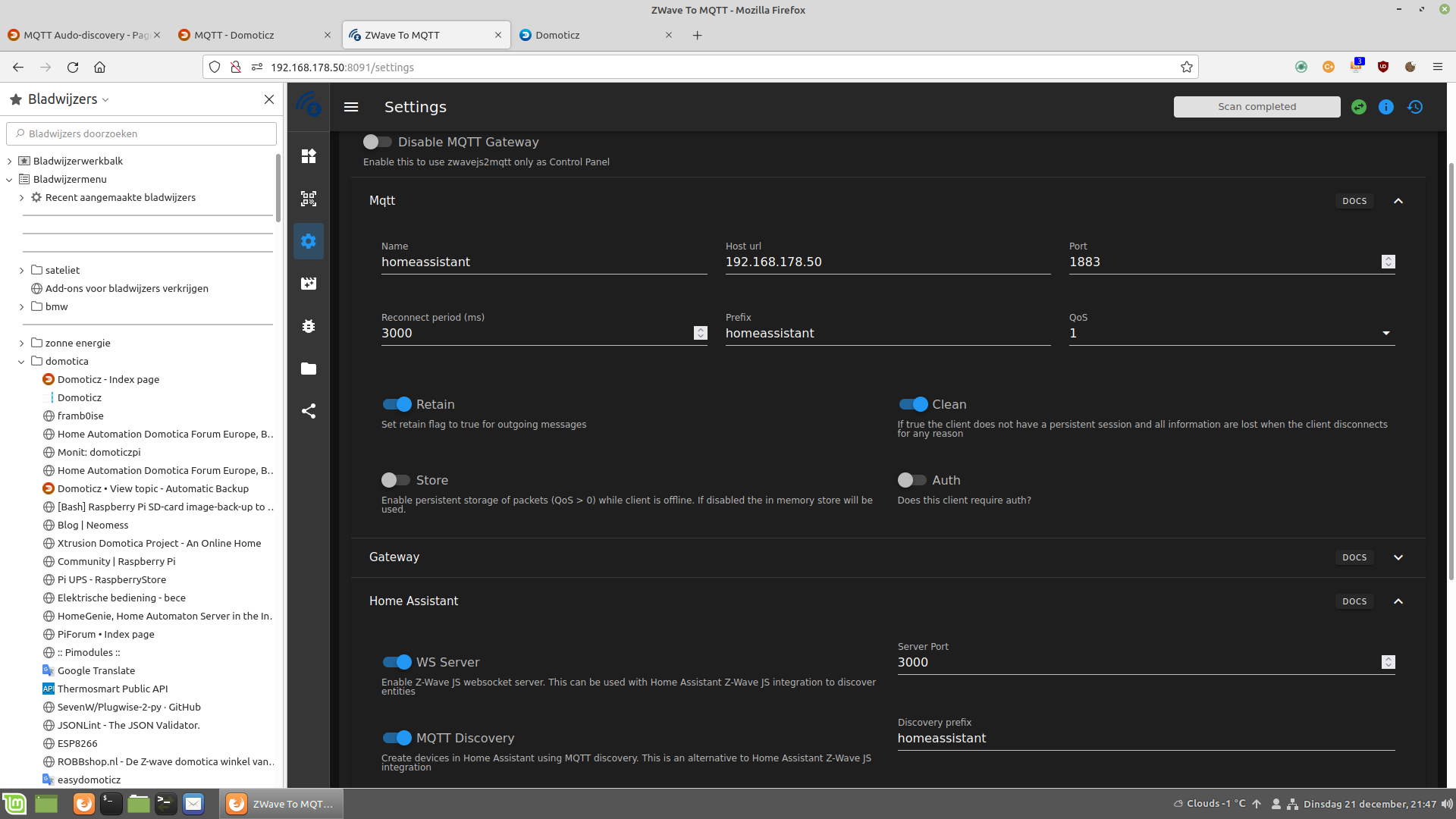

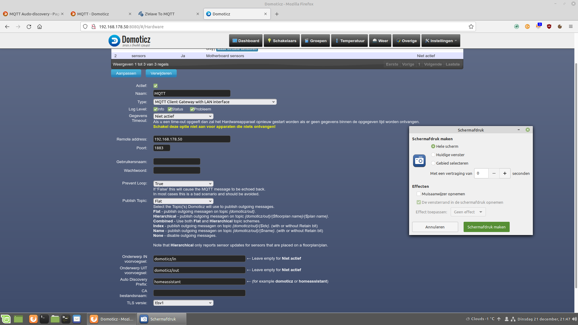

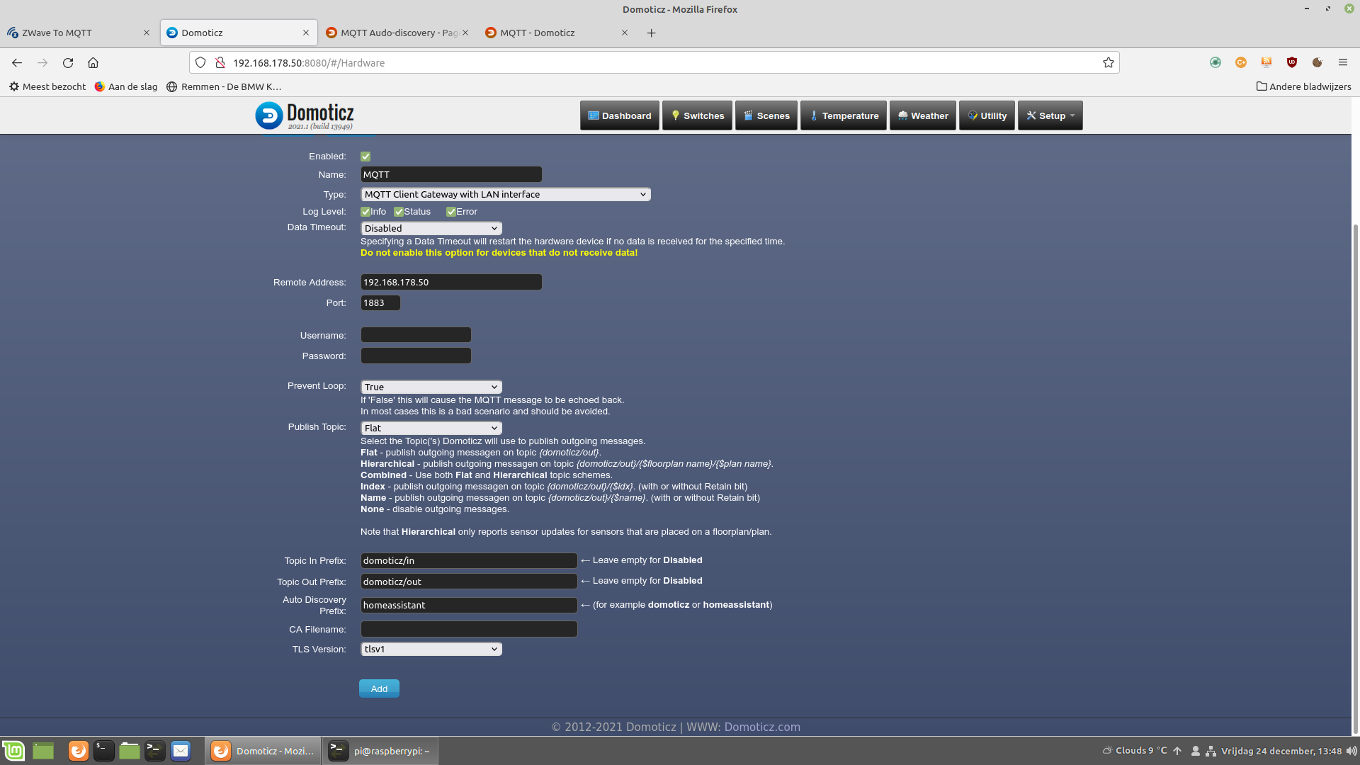

Still the same errors. I red different topics and combined the setting mentioned. This is what I have now:
Schermafdruk van 2021-12-21 21-46-45.png (252.47 KiB) Viewed 3628 times
Schermafdruk van 2021-12-21 21-47-06.png (231.68 KiB) Viewed 3628 times
Schermafdruk van 2021-12-21 21-47-33.png (236.5 KiB) Viewed 3628 times

MQTT PREFIX in ZWAVEJS2MQTT is still wrong! That sends the status updates and they should not go into the same topic as the autodiscovery (homeassistant)!
As stated in my previous post: That should be ZWAVE which it is by default. ;)

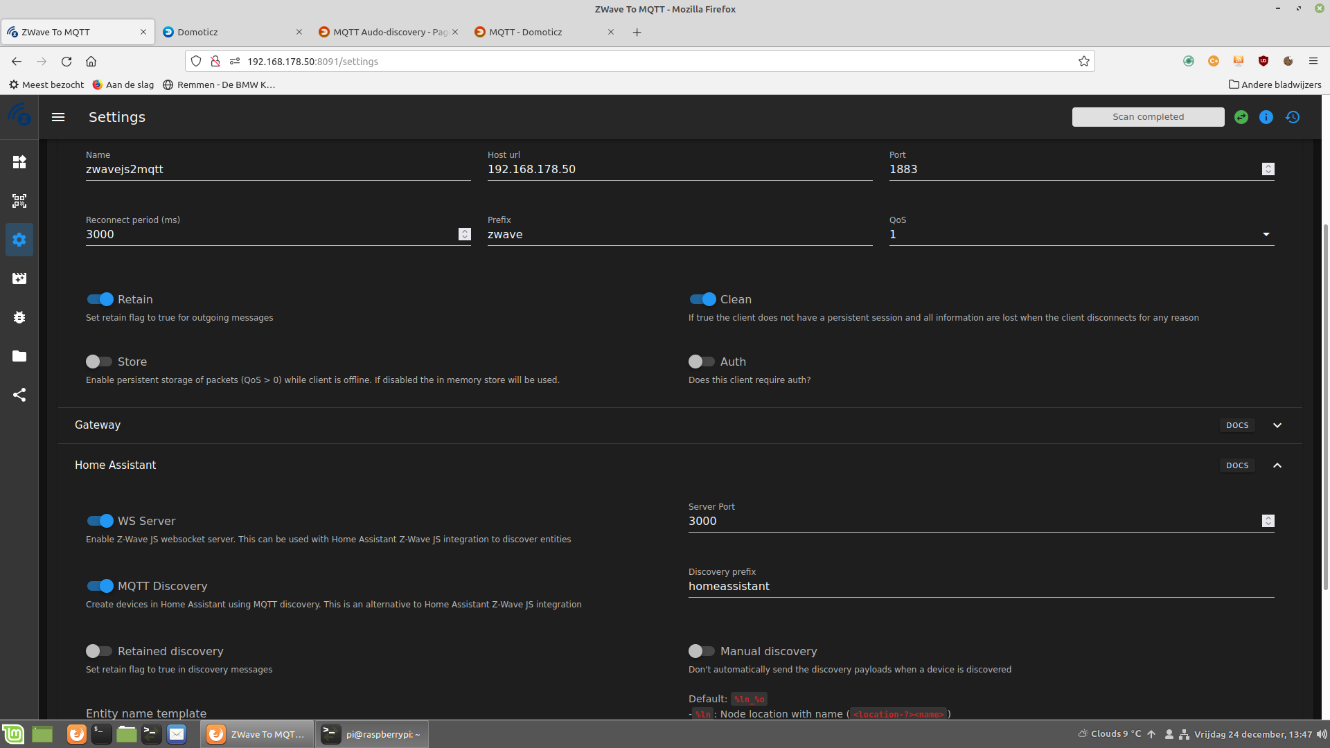

Still errors :shock: I think I changed everything you said.But the mqtt devices are in domoticz and working.When I restart the messages appear again.
Schermafdruk van 2021-12-24 13-47-54.png (161.71 KiB) Viewed 3560 times
Schermafdruk van 2021-12-24 13-48-25.png (199.37 KiB) Viewed 3560 times
 2021-12-24 13:45:00.003 Error: MQTT: MQTT_Discovery: Something other then 'config' received on discovery topic! (23/38/1/currentValue/{"time":1640349720033,"value":61,"nodeName":"Kamer dimmer","nodeLocation":"Huiskamer"})!
2021-12-24 13:45:00.003 Error: MQTT: MQTT_Discovery: Invalid/Unhandled data received! (Topic: 23/38/1/currentValue, Message: {"time":1640349720033,"value":61,"nodeName":"Kamer dimmer","nodeLocation":"Huiskamer"})
2021-12-24 13:45:00.203 Error: MQTT: MQTT_Discovery: Something other then 'config' received on discovery topic! (23/38/2/currentValue/{"time":1640349720096,"value":99,"nodeName":"Kamer dimmer","nodeLocation":"Huiskamer"})!
2021-12-24 13:45:00.203 Error: MQTT: MQTT_Discovery: Invalid/Unhandled data received! (Topic: 23/38/2/currentValue, Message: {"time":1640349720096,"value":99,"nodeName":"Kamer dimmer","nodeLocation":"Huiskamer"})
2021-12-24 13:45:07.985 MQTT: General/Current (Magnetron_electric_a_value)

jvdz wrote: Friday 24 December 2021 15:31
rron wrote: Friday 24 December 2021 15:28
jvdz wrote: Friday 24 December 2021 15:25 Did you remove all retained OLD wrong Messages from topic "HOMEASSISTANT" or else you will still be getting these errors each time you start Domoticz?
Where can I find this?
jvdz wrote: Monday 20 December 2021 18:01 OK... now check mqtt for the config messages send.
They should be in topic homeassistant and clean out all retained message in the wrong place topic domoticz.
See https://www.domoticz.com/wiki/MQTT#Debugging_MQTT
So, Just clean out TOPIC HOMEASSISTANT and probably also DOMOTICZ, as you had them initially in the wrong places. ;)
In the plugin?
