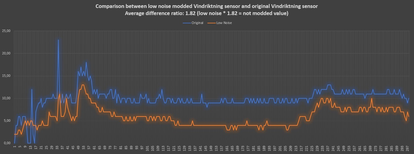

To find out what the difference in measurements is between a normal sensor and the sensor with the low noise mod, I've connected both setups and physically placed them right next to each other. Since the atmospheric circumstances are identical it gives me the exact difference in measurements.
After 24 hours of comparing the low noise modded sensor with the original sensor, I can conclude that the difference ratio between the two is ~1.82. So the 'real' value is the value of the low noise modded sensor times 1.82.
