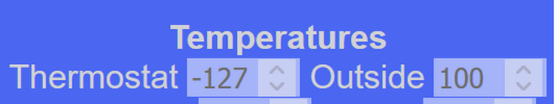

Maciek90
Posts: 55
Joined: Friday 05 March 2021 23:01
Re: OpenTherm weather dependent heating control
Post by Maciek90 »
What do the general status and opentherm status of the main screen of the firmware show?
as in the picture below

It’s working correctly. Your setpoint is set to 19. It recieves a value of 27 so the setpoint for the heating/cooling device is set to 10. What is the issue then?
Maciek90
Posts: 55
Post by Maciek90 »
Oh sorry, my mistake! I was looking at the Temperatures>Thermostat>-127 (like in the picture) readings. Now I know that the inside temperature works fine.

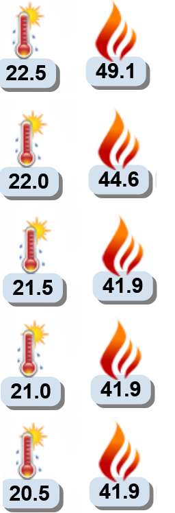

The heating season has been underway for a while now, so I tested your firmware and found a problem.
I'll show you what I mean with a screenshot. On the left is the set room temperature, and on the right is the calculated boiler water temperature. Currently, the actual room temperature is 21.7 degrees Celsius. Up to the set temperature of 21.5 degrees Celsius, the boiler water temperature also decreases. Below 21.5 degrees Celsius, the boiler water temperature remains unchanged and stops at 41.9 degrees Celsius. I've noticed that this value depends on the measured outside temperature. The colder it is, the higher the minimum boiler water temperature. In the software, I have the minimum boiler temp set to 30 degrees Celsius. In the previous version of your software, which used the Domoticz plugin, this problem did not exist. With a sufficiently low set temperature, the calculated boiler temperature approached the set minimum value (30 degrees Celsius). Unfortunately, this is no longer the case, which often causes my house to overheat.
akamming
Posts: 422
Joined: Friday 17 August 2018 14:03
Post by akamming »
Maciek90 wrote: Monday 24 November 2025 0:09 The heating season has been underway for a while now, so I tested your firmware and found a problem.
What heating mode is used (climate or weather dependent?) what is the config of the boiler parameters?

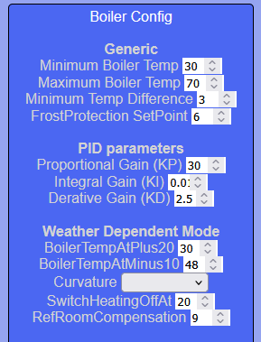

Maciek90
Posts: 55
Post by Maciek90 »
Weather dependent mode
Like on the picture
