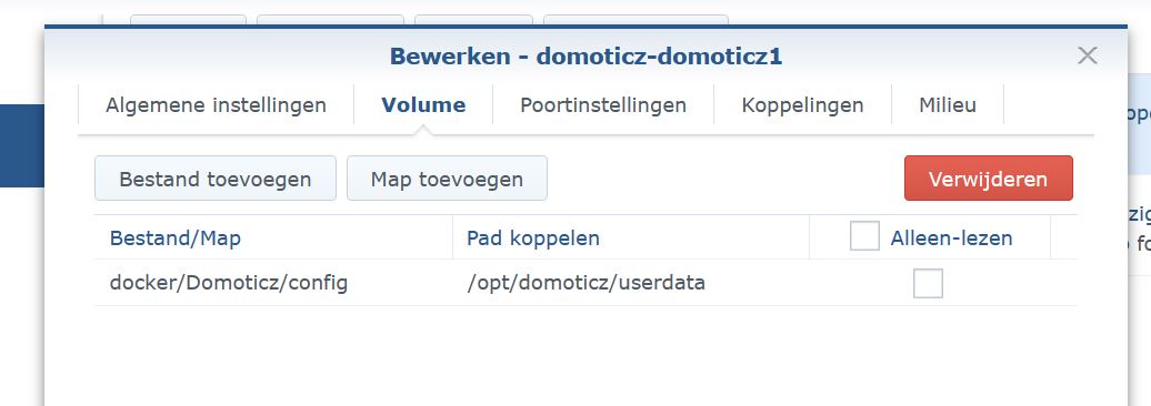

I am a still confused. This is my screen. Is this the correct way?
- Knipsel.JPG (48.02 KiB) Viewed 6010 times

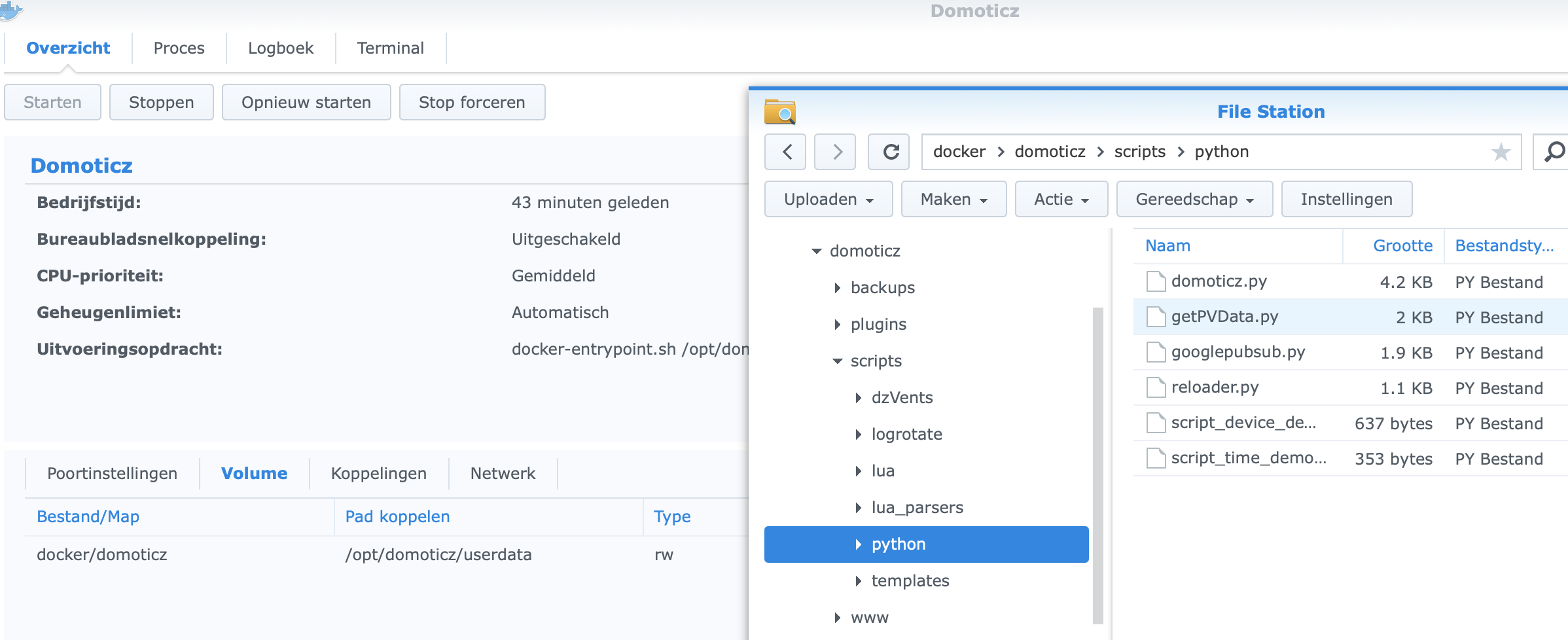

Could someone explain where the scripts are stored in the docker container?
I have copied the scripts folder from my previous (Jadahl package) setup to the docker/domoticz (which is connected to /opt/domoticz/userdata).
But the scripts inside Domoticz are not in sync with the scripts in this folder. I get an error when I run a .py script:
sh: 1: {command of the script, eg. /opt/domoticz/userdata/scripts/python/1234546.py} not found
But when I look in the folder /opt/domoticz/userdata/scripts/python/123456.py is there (I use file station so I look inside /volume1/docker/domoticz/scripts/python/)
And when I add a new script it is nowhere to be found in the scripts folder. So it looks like the scripts are stored somewhere else?
I am moving from the Jadahl-package to the official Docker-image, mainly because the package is no longer supported.
The complete setup was still working perfect, but wanted to change before DSM 7 messed things up

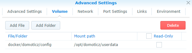

Hi Harrie,Harrie wrote: Monday 22 February 2021 21:09 I am a still confused. This is my screen. Is this the correct way?
I have the same setup, but I didn't use a config folder. But this should not matter afak.
In File Station you are now able to see the Domoticz-docker files, correct?
Screenshot is because of some other issue, but you can see the connection I made between domoticz/docker and /opt/domoticz/userdata

And when I edit a DzVent script in Domoticz Interface and save that, I see the change when I go to volume1/docker/domoticz/scripts/dzvents/generated_scripts/[scriptname].lua. So the connection between Domoticz and the folder in File Station is there.Stormryder wrote: Tuesday 23 February 2021 8:38 Could someone explain where the scripts are stored in the docker container?
The complete setup was still working perfect, but wanted to change before DSM 7 messed things up.

Cheers,
Today i switched from the Linuxserverio docker image to the official docker image.
Seems to work fine in general but i cant import my scripts folder from the old docker image.
Scripts should be located in /opt/domoticz/scripts but that map is empty on the image.
i made an persistent link in the docker config and added my folder with scripts to it.
In the docker image with docker exec -it DomoticzMaster ls -l /opt/domoticz/scripts/ i can see my scripts so thats working ok.
Nevertheless domoticz cant see my scripts there in the events window and if i create a new event (Blocky/Lua/Dzvents) i cant see that file being generated anywhere?
Someone who can tell me where to find them?
Cheers,
Jumper3126
- Posts: 105
- Joined: Thursday 31 December 2015 15:26
Re: Oficial Docker Container
Just for my understanding, is it correct that with this script, I can create my own containers, instead of using the containers from the dockerhub?
Although I'm not very experienced in linux, it doesn't look completely un-doable.
First you have to decide where to put the "external" files. I put those in "/volume1/docker/domoticz"Harrie wrote: Sunday 14 February 2021 14:17 So what do i enter in 'Bestand/Map' and 'Pad koppelen' in DSM? Do i have to enter something in 'Mileu' ??
My 'best' logging so far is: Error: SQLHelper: Error script not found '/opt/domoticz/userdata/scripts/hs/hsDomCopy.py'
The /opt/domoticz/userdata is unknown to me!.
Any help welcome.
Thanks in advance
Make config directory like
mkdir /volume1/docker/domoticz/config When you launch Domoticz in Docker put this folder in Advanced Settings If you want to use other port settings etc.. put those in Environment.
In my Synology NAS there is docker-compose present, check if it is in yours. This is a better/easier way to get a container running.
