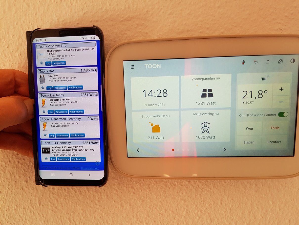

Thanks the logging is a little bit verbose, but all good;) Will fix it for the next release.madpatrick wrote: ↑Wednesday 30 December 2020 11:36Tried v1.02 and see this in the log. Not sure this is ok.hansaplast31 wrote: ↑Wednesday 30 December 2020 11:11 Version 1.0.2 is on git. zwave devices are now being read out
there are now three devices for gasflow/counter, electricity current usage/counter & generated electricity current delivery/counter.
the biggest struggle so far has finding the right device type, and I believe there is still room for improvement there.Code: Select all
2020-12-29 17:32:02.984 Status: (Toon2) Initialized version 1.0.2, author 'Hansaplast31' 2020-12-29 17:32:02.987 Status: (Toon2) Entering work loop. 2020-12-29 17:32:03.051 (Toon2) getZwaveInfo created 2020-12-29 17:32:03.110 (Toon2) Update 0:'18.8' (Toon2 - Current Temperature) 2020-12-29 17:32:03.111 (Toon2) Update 0:'19.0' (Toon2 - Setpoint Temperature) 2020-12-29 17:32:03.113 (Toon2) Update 0:'10' (Toon2 - Auto Program) 2020-12-29 17:32:03.114 (Toon2) Update 0:'50' (Toon2 - Program) 2020-12-29 17:32:03.115 (Toon2) Update 0:'No information received from Toon yet (-1)' (Toon2 - Program info) 2020-12-29 17:32:03.115 (Toon2) Update 0:'1.7' (Toon2 - Boiler pressure) 2020-12-29 17:32:03.116 (Toon2) Update 0:'0;0' (Toon2 - Electricity) 2020-12-29 17:32:03.117 (Toon2) Update 0:'0;0' (Toon2 - Generated Electricity) 2020-12-29 17:32:13.130 (Toon2) getZwaveInfo created 2020-12-29 17:32:23.202 (Toon2) getZwaveInfo created 2020-12-29 17:32:33.241 (Toon2) getZwaveInfo created 2020-12-29 17:32:43.330 (Toon2) getZwaveInfo created 2020-12-29 17:32:53.329 (Toon2) getZwaveInfo created 2020-12-29 17:33:03.414 (Toon2) getZwaveInfo created 2020-12-29 17:33:13.483 (Toon2) getZwaveInfo created 2020-12-29 17:33:23.521 (Toon2) getZwaveInfo created 2020-12-29 17:33:33.579 (Toon2) getZwaveInfo created 2020-12-29 17:33:43.624 (Toon2) getZwaveInfo created 2020-12-29 17:33:53.708 (Toon2) getZwaveInfo created 2020-12-29 17:34:03.743 (Toon2) getZwaveInfo created 2020-12-29 17:34:13.809 (Toon2) getZwaveInfo created 2020-12-29 17:34:23.849 (Toon2) getZwaveInfo created 2020-12-29 17:34:33.933 (Toon2) getZwaveInfo created 2020-12-29 17:34:43.993 (Toon2) getZwaveInfo created 2020-12-29 17:34:54.044 (Toon2) getZwaveInfo created 2020-12-29 17:35:04.057 (Toon2) getZwaveInfo created 2020-12-29 17:35:14.113 (Toon2) getZwaveInfo created 2020-12-29 17:35:24.158 (Toon2) getZwaveInfo created 2020-12-29 17:35:34.199 (Toon2) getZwaveInfo created 2020-12-29 17:35:44.305 (Toon2) getZwaveInfo created 2020-12-29 17:35:54.331 (Toon2) getZwaveInfo created 2020-12-29 17:36:04.409 (Toon2) getZwaveInfo created 2020-12-29 17:36:14.461 (Toon2) getZwaveInfo created 2020-12-29 17:36:24.551 (Toon2) getZwaveInfo created 2020-12-29 17:36:34.605 (Toon2) getZwaveInfo created 2020-12-29 17:36:44.639 (Toon2) getZwaveInfo created 2020-12-29 17:36:54.719 (Toon2) getZwaveInfo created 2020-12-29 17:37:04.757 (Toon2) getZwaveInfo created 2020-12-29 17:37:14.820 (Toon2) getZwaveInfo created 2020-12-29 17:37:24.881 (Toon2) getZwaveInfo created 2020-12-29 17:37:34.971 (Toon2) getZwaveInfo created 2020-12-29 17:37:44.985 (Toon2) getZwaveInfo created 2020-12-29 17:37:45.044 (Toon2) Update 0:'1.9' (Toon2 - Boiler pressure) 2020-12-29 17:37:55.065 (Toon2) getZwaveInfo created 2020-12-29 17:38:05.120 (Toon2) getZwaveInfo created 2020-12-29 17:38:15.221 (Toon2) getZwaveInfo created 2020-12-29 17:38:25.275 (Toon2) getZwaveInfo created 2020-12-29 17:38:35.299 (Toon2) getZwaveInfo created 2020-12-29 17:38:45.352 (Toon2) getZwaveInfo created 2020-12-29 17:38:55.380 (Toon2) getZwaveInfo created 2020-12-29 17:39:05.470 (Toon2) getZwaveInfo created 2020-12-29 17:39:15.520 (Toon2) getZwaveInfo created 2020-12-29 17:39:25.587 (Toon2) getZwaveInfo created 2020-12-29 17:39:35.679 (Toon2) getZwaveInfo created 2020-12-29 17:39:45.712 (Toon2) getZwaveInfo created 2020-12-29 17:39:55.787 (Toon2) getZwaveInfo created 2020-12-29 17:40:05.855 (Toon2) getZwaveInfo created 2020-12-29 17:40:15.931 (Toon2) getZwaveInfo created
The plugin is getting better !
For me the Energy device is currently the P1 and is working fine.
You can see the (realtime) energy flow from consumption and delivery (solar) in 1 device.
and also the actual use and total day use of both.

I have a Toon V2 and solar panels.
I have installed the plugin and added hardware.
I now have 2 devices:
Toon-Electricity and Toon-Generated Electricity
I get to see values that I do not understand when I compare these values with the values indicated on Show.
- madpatrick
- Posts: 669
- Joined: Monday 26 December 2016 12:17
- Domoticz version: 2025.1
Re: Rooted Toon plugin
Maybe the sequence of the values is not good.hennykarreman wrote: ↑Monday 01 March 2021 15:14 I have a Toon V2 and solar panels.
Check in the hardware section the values sequence
Toon v2 Zwave values (unconfirmed): 2.1, 2.4, 2.6, 2.5, 2.7
-= HP server GEN11 =- OZW -=- Toon2 (rooted) -=- Domoticz v2025.1 -=- Dashticz v3.14b on Tab8" =-
