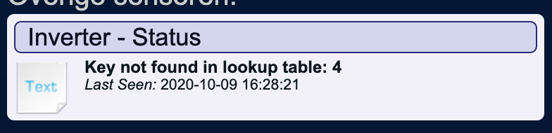

I just updated the plugin. did NOT have errors before, NOW I see
Screenshot 2020-10-09 at 16.28.55.png (36.41 KiB) Viewed 1959 times
Where should I look for more info ?
Before it said "producing"

Oops..... Uploaded the wrong version to GitHub...
Will fix it now.

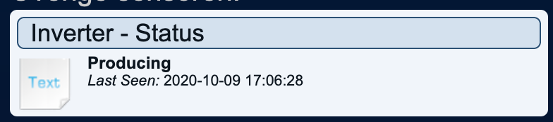

looks OK now here ;-) thanks for fixing

eddieb wrote: Friday 09 October 2020 16:29 Hi,
Uploaded the correct version to GitHub now.
If you would be so kind to upgrade one more time.
It should then work fine again.
Sorry for the mixup....

826|0|Key not found in lookup table: 4||2020-10-09 16:28:21
826|0|Producing||2020-10-09 17:06:28
