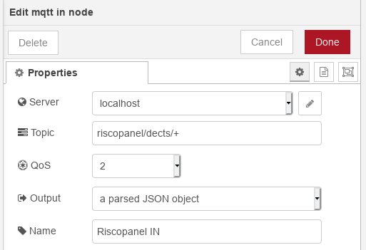

Create 2 MQTT input modules and configure them as follows:
Configure the first MQTT Input node as follows:
and the second MQTT Input node as follows:
Can you post what you see in both Debug nodes?
And one more question: How many motion detectors do you have installed, which you want to see in Domoticz?
If I have these answers I can create a Function node.

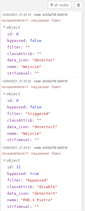

FireWizard
Posts: 1967
Location: Voorthuizen (NL)
Re: Risco Lightsys alarm system - Domoticz
Post by FireWizard »
Hello @zabinskiwojciech
I read the source code once more and I believe that the topic riscopanel/dects/<Id_number>/status is not really used.
You did not see it changing either.
So we only use riscopanel/dects/<Id_number>
From all the posts, I have collected the following examples:
The top one shows the normal (quiescent) situation for detector 0.
The middle one shows the same detector in ALARM condition.
The lower one shows detector 11 in DISABLED condition.
I understand you want to use a virtual Switch for alarm.
We can try that, but then we cannot show the disabled condition.
Perhaps a suggestion to create both an Alert Sensor with the following colors:
1. Green for Normal (No alarm and Enabled)
2. Yellow for Disabled
3. Red for Alarm (and Enabled)
And in addition a Switch for Alarm.
You can switch the lights in case of an alarm.
In that case you have to create 9 virtual Alert Sensors and maximum 9 virtual Switches.
If you want to combine let me know.

Hello @zabinskiwojciech,
I have looked to the details and created a flow (stream) similar to the other two.

The MQTT Input node has to be configured as follows:
See the picture: Screenshot_Risco-Intruderpanel12.png in my post of 12 Apr 2021, 14:47

Hello, I have slightly modified what you sent so that it would only turn on the Alert sensors.
Nice that it worked, thank you for your help.
It doesn't work as I thought (very long latency) around 15-20 seconds, I could reduce the polling time in risco-mqtt and maybe that would help but I ran into another bug.
The motion detectors I have on the first floor are connected by the expansion module and maybe therefore they do not transmit the alarm state to the cloud. I fired in the node-red MQTT with the theme riscopanel / dects / 12 / #, but it does not find the motion detection status, although the LED on the detector lights up.
shows in logs only :
13.04.2021, 21:16:52node: 1e473109.8521f7
riscopanel/dects/12 : msg.payload : string[119]
"{"id":12,"bypassed":false,"filter":"","classAttrib":"","data_icon":"detector","name":"KORYTARZ Pietro","strTimeval":""}"
13.04.2021, 21:16:55node: 1e473109.8521f7riscopanel/dects/12/status : msg.payload : string[6]
"active"
13.04.2021, 21:23:36node: 1e473109.8521f7riscopanel/dects/12 : msg.payload : string[119]
13.04.2021, 21:23:39node: 1e473109.8521f7riscopanel/dects/12/status : msg.payload : string[6]
"active"

I see that you have spaces in: riscopanel / dects / 12 / #. That is not correct. Remove them in your MQTT Input node.
I do not think I can help you further with this problem. I see also in your log file that "triggered" is missing.
Perhaps to contact the supplier or manufacturer is a solution, but I do not know if they will respond.

The space character is missing in my MQTT receiver crept in when I copy and paste.
