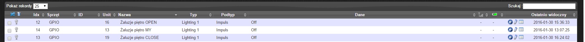

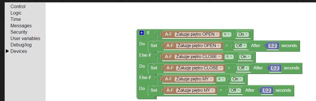

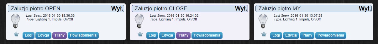

I have a problem. I want use GPIO relay on Raspberry to control my Blinds by remote Telis 4 RTS.
I use 2 relay connect by GPIO to my Raspberry with Domoticz. I use wirePi library to control GPIO by Domoticz. I create Switch with set GPIO o open and to Close Blinds. But i Have one problem. Pulse from relay is too long. Longer then when i press button manual on remote. I user events with set time 0.2 secund but nothing change... WHen i click example on close switch sometimes i hear that relay has long time pulse sometime short time pulse. How can i set time to relay by GPIO to shorter less than 0.2 secund ? Because problem is that relay has too long pulse and when pulse is too long blinds not close , it change position step by step.
Maybe i can use script with set time pulse for relay ?
Please i need help
