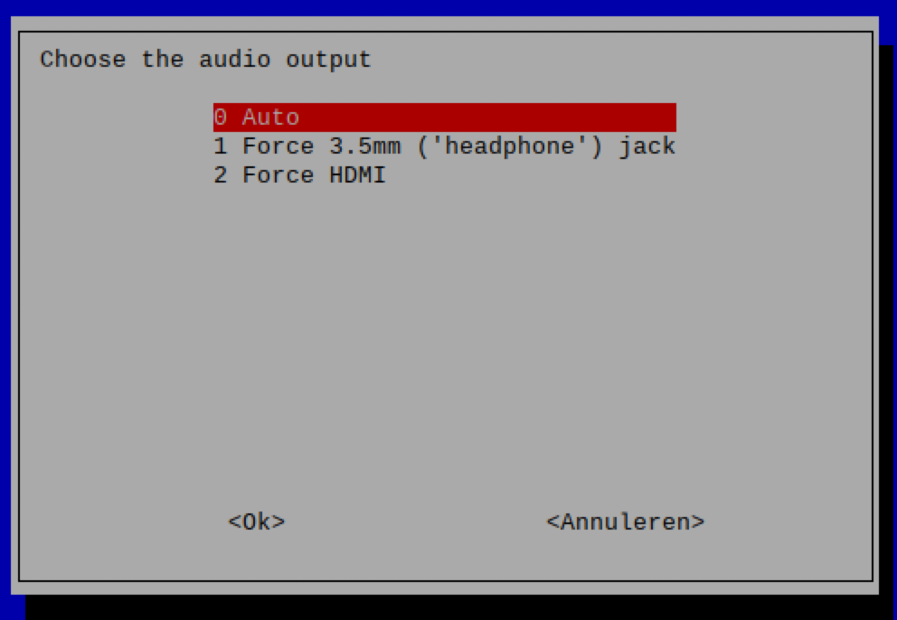

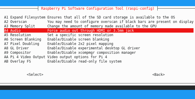

- HansieNL
- Posts: 994
Re: After Buster April update Bash Sound scripts stops working
Have you tried to force the sound to jack via raspi-config?
sudo raspi-config - Advanced Options - Audio ( Force audio out through HDMI or 3.5mm jack )

McJohn
- Posts: 91
- Joined: Wednesday 10 October 2018 17:01
- Domoticz version: 2020.2
Thanks for both answers.
When I do:
It keeps sending the audio commands from Domoticz to the HDMI port.
Is there no master command for the root to force audio via analog 3.5 mm output?
When I do:
And I already tried:pi@raspberrypi:~ $ amixer cset numid=3 0
amixer: Cannot find the given element from control default
pi@raspberrypi:~ $ sudo amixer cset numid=3 0
(I think this option is also for User "Pi"?)sudo raspi-config - Advanced Options - Audio ( Force audio out through HDMI or 3.5mm jack )

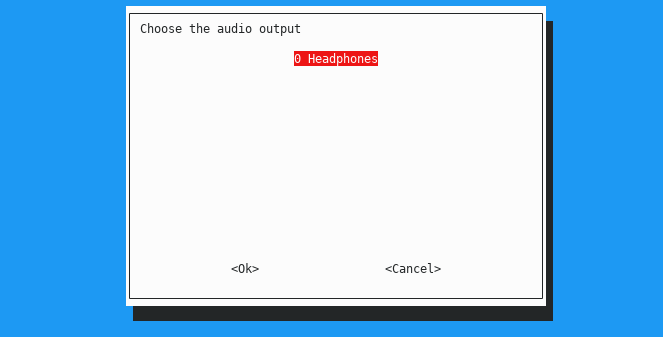

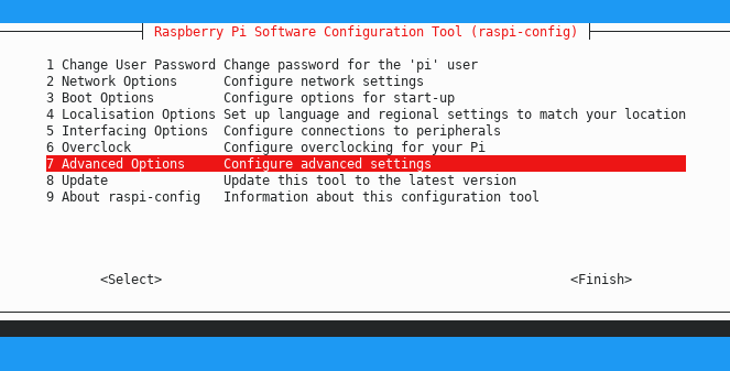

@McJohn
I looked to it once more.
I did the following:
As you can see, I don't have HDMI connected.
You can try to issue just the command, after you run the raspi-config (as above):
without setting amixer.
I do not have further suggestions. If the Raspberry Pi engineers have no idea, then it will be difficult.
@McJohn
sudo raspi-configYou can try to issue just the command, after you run the raspi-config (as above):
espeak -v nl+f4 -s 180 "Sound. On" --stdout | aplayI do not have further suggestions. If the Raspberry Pi engineers have no idea, then it will be difficult.

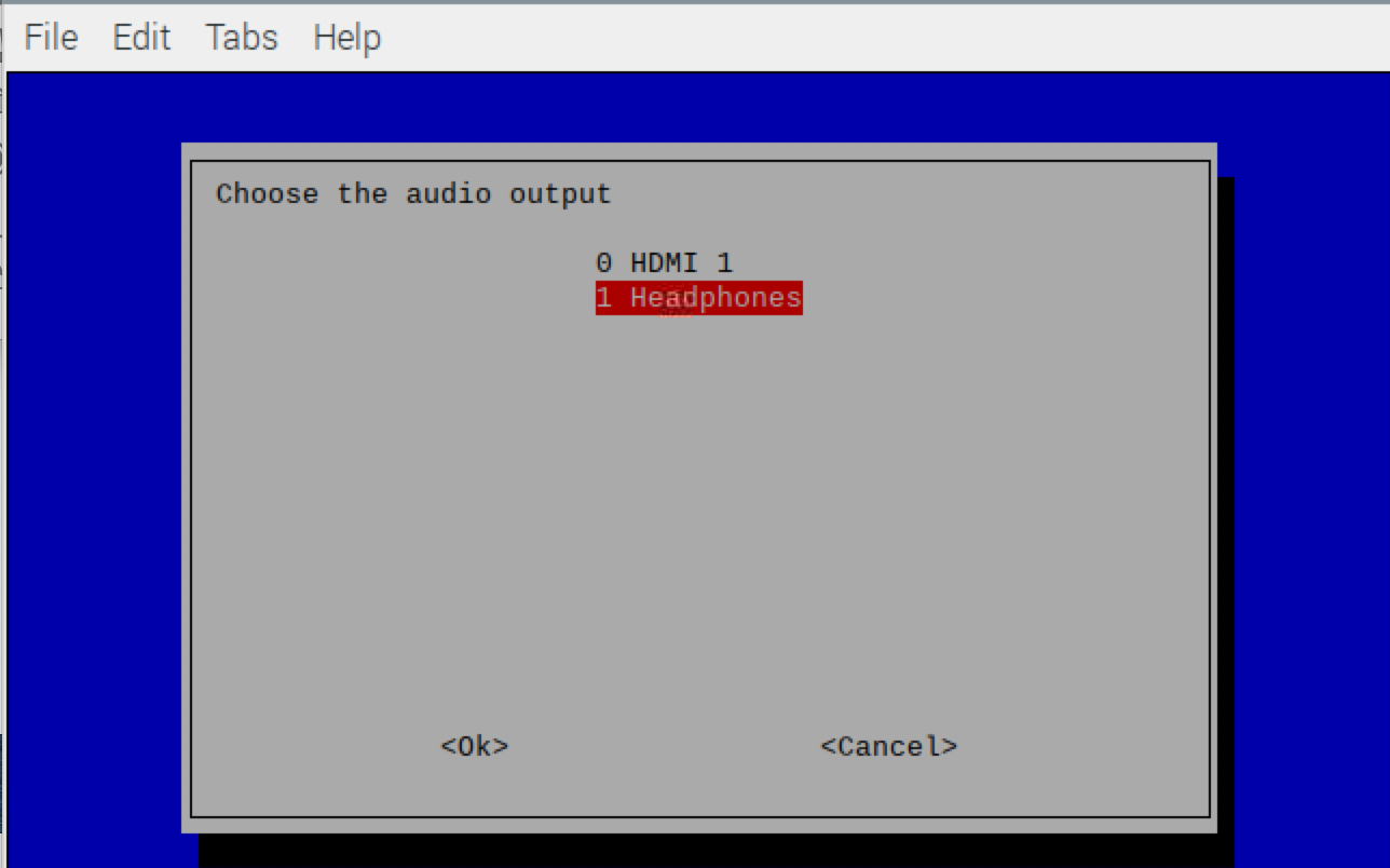

McJohn
- Posts: 91
Thank you very much for your contribution.
You are a (very) lucky person that you don't have the HDMI option!
In my case HDMI want to play the master role and with or without an HDMI screen, with user root it's always HDMI.
(Sudo Raspi-config gives 2 options: 0 HDMI and 1 Headphones)
This is with an upgrade of the January version of Buster AND also with a fresh new image of the Raspberry site.
Tried your suggestions but unfortunately same results:
Bash script (your code) is working perfect in the GUI and Terminal but from Domoticz no sounds.
OK, I think I have to go back in time and go to the January version of Buster.
That one works good and stable and finally time should give us a solution...
Thanks again for all your time and work!
Kind regards.
Kind regards.
- Screen Shot 2020-06-14 at 16.24.36.png (112.16 KiB) Viewed 2524 times
McJohn
- Posts: 91
And this is the difference with the January version of Buster in Raspi-config) (At a Rpi 3B+):
- Screen Shot 2020-06-14 at 17.08.38.png (81.93 KiB) Viewed 2524 times
