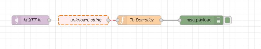

The next step is Node Red.
I assume you have also installed Node Red on the same hardware as Mosquitto, Domoticz and your pcomfortcloud.py script.
If your browser is also installed on the same hardware use IP address 127.0.0.1 or otherwise the IP address of the device, which has Node Red installed.
If so open a browser and go to http://127.0.0.1:1880 and the Node Red workbench will open
In the "Hamburger" menu at the top right, go to "Import" and paste the following flow:
[{"id":"5bae5c9d.cc469c","type":"tab","label":"Pansonic Cloud","disabled":false,"info":""},{"id":"895546b7.2d10c","type":"mqtt in","z":"5bae5c9d.cc469c","name":"MQTT In","topic":"panasonic/living","qos":"2","datatype":"auto","broker":"c2d9657a.d81bf8","x":160,"y":320,"wires":[["d0c887a4.afd0e"]]},{"id":"d0c887a4.afd0e","type":"debug","z":"5bae5c9d.cc469c","name":"","active":true,"tosidebar":true,"console":false,"tostatus":false,"complete":"payload","targetType":"msg","x":330,"y":320,"wires":[]},{"id":"c2d9657a.d81bf8","type":"mqtt-broker","broker":"127.0.0.1","port":"1883","clientid":"","usetls":false,"verifyservercert":true,"compatmode":true,"keepalive":15,"cleansession":true,"birthQos":"0","willQos":"0"}]

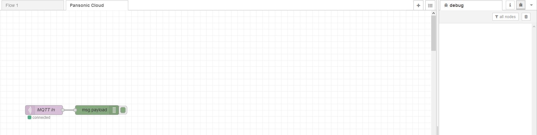

It will show the following:
Go to the debug pane (the bug symbol just under the "Hamburger" menu.
If both the bash script and the Node Red flow are correctly installed, you will see approx. every minute the result in the debug pane.
Can you publish the content of what you see. A screenshot would be fine.

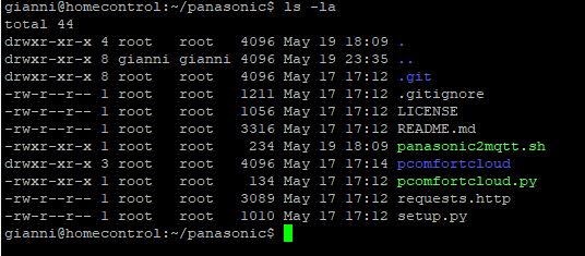

add the bash into the same folder as the python script
Chmod the bash
copy the code into node red.
The only thing i added was to start node red on boot,because now i have to start node red manual everytime
https://nodered.org/docs/faq/starting-node-red-on-boot
greets gianni

is used the script with the combine options.
Not running in node red.
I need to start it again like ./panasonic2mqqt.sh
when i quit it's stopt running in node red.
Then in ONLY see the first unit (livinig) and not the second (slaapkamer)
Just to be clear i only add the sh file in the same folder as the python script,add the line's in it and chmod the file.
mvg Gianni
That is correct. Can you publish the file?
The fact that you see only the first message is because you did not subscribe to the second message.
To do so:
Double click the MQTT In node.
Change the topic panasonic/living to panasonic/# (This # is a "wildcard")
Press "Done" and press "Deploy"
You should see now both

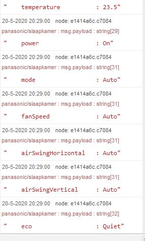

i got the 2 devices,but every command in another line.
see screenshot to clear out :-)
mvg Gianni

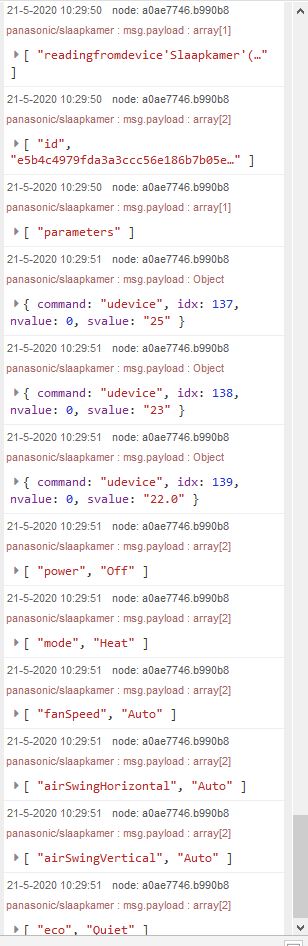

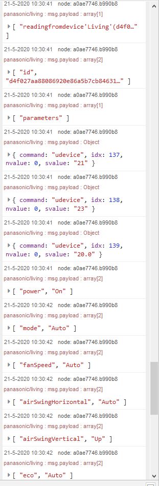

If everything is correct you will now see in the debug pane of Node Red about 11 messages for each topic (11 for Living and 11 for Bedroom)
Can you publish all messages
is sent in into a pb
grts gianni

Can you try the following flow.
Replace the 2 nodes with this one:
[{"id":"895546b7.2d10c","type":"mqtt in","z":"5bae5c9d.cc469c","name":"MQTT In","topic":"panasonic/#","qos":"2","datatype":"auto","broker":"c2d9657a.d81bf8","x":160,"y":320,"wires":[["ccb5a50f.4461e8"]]},{"id":"ccb5a50f.4461e8","type":"string","z":"5bae5c9d.cc469c","name":"Trim ","methods":[{"name":"strip","params":[{"type":"str","value":" "}]},{"name":"split","params":[{"type":"str","value":":"},{"type":"num","value":"2"}]}],"prop":"payload","propout":"payload","object":"msg","objectout":"msg","x":330,"y":320,"wires":[["7f7c8cad.7614fc"]]},{"id":"7f7c8cad.7614fc","type":"function","z":"5bae5c9d.cc469c","name":"To Domoticz","func":"switch (msg.payload[0]) {\n\n    case \"temperatureInside\":\n    msg.payload = {\"command\":\"udevice\",\"idx\":8,\"nvalue\":0,\"svalue\":msg.payload[1]};\n    break;\n    \n    case \"temperatureOutside\":\n    msg.payload = {\"command\":\"udevice\",\"idx\":9,\"nvalue\":0,\"svalue\":msg.payload[1]};\n    break;  \n    \n    case \"temperature\":\n    msg.payload = {\"command\":\"udevice\",\"idx\":10,\"nvalue\":0,\"svalue\":msg.payload[1]};\n    break;\n}\n\nreturn msg;","outputs":1,"noerr":0,"x":510,"y":320,"wires":[["9fb89083.61ba9"]]},{"id":"9fb89083.61ba9","type":"debug","z":"5bae5c9d.cc469c","name":"","active":true,"tosidebar":true,"console":false,"tostatus":false,"complete":"false","x":710,"y":320,"wires":[]},{"id":"c2d9657a.d81bf8","type":"mqtt-broker","z":"","name":"","broker":"127.0.0.1","port":"1883","clientid":"","usetls":false,"verifyservercert":true,"compatmode":true,"keepalive":"60","cleansession":true,"birthTopic":"","birthQos":"0","birthPayload":"","closeTopic":"","closePayload":"","willTopic":"","willQos":"0","willPayload":""}]
If everything is allright you will see something like this:
If you run the script (with -l option) you should see something like:
You will see that 3 times.
i got a error in trim(unknow string)
P.S. Service file will follow tomorrow
NP thx you to take so much time to get this work :-)

Hi @Gianni,
I should have told you that the string node is not a default node in Node Red.
In Node Red goto the "Hamburger" menu and select "Manage palette".
Go to the "Install" tab and search for: node-red-contrib-string
Install this module.

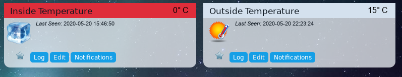

For your information a screenshot of the Inside/Outside temperature.
The rest will follow tomorrow.

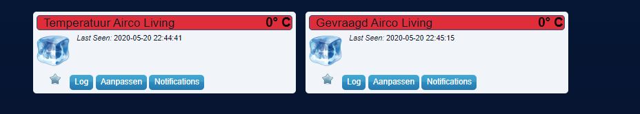

so i did a little testing yesterday.
i create a dummy switch and add some temp devices's on .
Add my idx to the node red domoticz
    case "temperatureInside":
    msg.payload = {"command":"udevice","idx":137,"nvalue":0,"svalue":msg.payload[1]};
    break;
    case "temperatureOutside":
    msg.payload = {"command":"udevice","idx":138,"nvalue":0,"svalue":msg.payload[1]};
    break;
    case "temperature":
    msg.payload = {"command":"udevice","idx":139,"nvalue":0,"svalue":msg.payload[1]};
    break;
return msg;
but i got no value so i think i'm not ready to do it allone :lol: :lol: :lol:
another thing that i see in that my living and slaapkamer get the same idx in node red debug
panasonic/living : msg.payload : Object
{ command: "udevice", idx: 139, nvalue: 0, svalue: "20.0" }
panasonic/slaapkamer : msg.payload : Object
{ command: "udevice", idx: 139, nvalue: 0, svalue: "22.0" }
grts Gianni

Hello goodmorning.
@Gianni
You area little bit ahead of me. :D
The current script does not make a difference between the topics . So all values go to the same IDX
It has to be added, but therefore I would appreciate to see one or more screenshot from the debug node connected to the MQTT Out node.
I expect also some errors from a couple of non relevant messages such as:
reading from device 'Living' (********************************************************id**********************************)
id : ********************************************************id**********************************
parameters
We did not discuss, that you had to connect Domoticz to your MQTT server.

In order to prepare the service file I have a question:
On what hardware is everything running and Domoticz version?
Is it using as init SysV or systemd?
i have a hp dl360 rack server raid5.
50 gig ram cpu @2.10 GHz with 6 cores
running esxi on the host.
Domoticz is running on ubuntu server 20.04
vm got 1 cpu ,2 gig ram and a 60 gig hdd
Domoticz version is Version: 2020.1 (build 11981)
mvg Gianni

@Gianni,
Thank you for the pictures, it is what I need.
Please find below a "service" file.
I suggest that you call the file: panasonic2mqtt.service.
