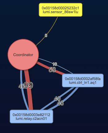

made a small update:
- taken into account all the shortcomings revealed above
- changed the method of calling the script to build the graph (now the + x attribute is not required)
- increased connections between nodes for better appearance of the graph.
Zigbee2mqtt network map

Re: Zigbee2mqtt network map
- screenshot2.png (84.74 KiB) Viewed 1033 times
snuiter
- Posts: 67
- Joined: Saturday 17 June 2017 12:30
installed it just now, thanks this works great ! good work

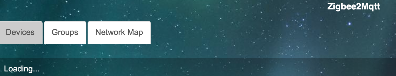

Nautilus
- Posts: 722
- Joined: Friday 02 October 2015 12:12
- Location: Finland
haven't got around to updating to Buster so running still:
I have just installed Zigbee2mqtt an it is working great, only issue is the network map showing just "loading...". Should it work with this version now without any modifications? Instruction above refer to older version I assume, as the file names are different now.
