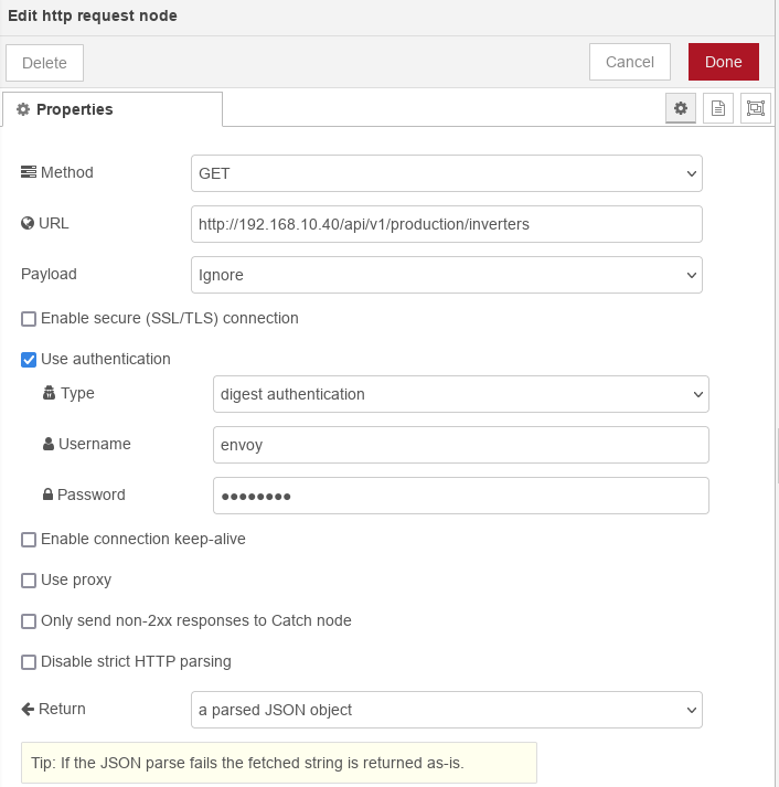

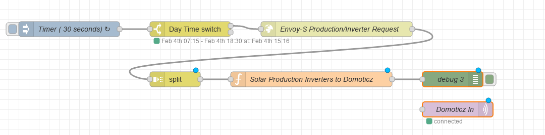

You can compare the results with the flow below, which you can install on your Pi4.
This flow does not use any part of the Domoticz software. It reads the API and outputs data to Domoticz (MQTT) or a "Debug" Node.
The left Inject Node triggers the flow every 30 seconds. It is up to you to change it.
The next "Day Time Switch" opens the flow from 1 hour before sunrise until 1 hour after sunset.
The HTTP request node polls the API Envoy (Gateway).
You have to set the foolowing parameters yourself:
1. URL. Use your own IP address
2. Username. In my case "Envoy"
3. Password. Last 6 digits of the Envoy (Gateway) serialnumber
The next node splits the data, so that we have one message per inverter.
The "Function" node sends in to the correct Domoticz iDX
You should do the mapping yourself.
Try it and compare.

        "spltType": "str",
        "arraySplt": 1,
        "arraySpltType": "len",
        "stream": false,
        "addname": "",
        "x": 430,
        "y": 400,
        "wires": [
                "86287b9b.69f7b8"
        "id": "86287b9b.69f7b8",
        "type": "function",
        "z": "fa8c9e54db2d0f2a",
        "name": "Solar Production Inverters to Domoticz",
        "func": "switch (msg.payload.serialNumber) {\n\n    case \"121851005629\": //Solar Panel 1\n    if ((msg.payload.lastReportWatts) < 0) (msg.payload.lastReportWatts) = 0;\n    msg.payload = {\"command\":\"udevice\",\"idx\":263,\"nvalue\":0,\"svalue\":((msg.payload.lastReportWatts).toString() + \";0\")};\n    break;\n\n    case \"121851003477\": //Solar Panel 2\n    if ((msg.payload.lastReportWatts) < 0) (msg.payload.lastReportWatts) = 0;\n    msg.payload = {\"command\":\"udevice\",\"idx\":264,\"nvalue\":0,\"svalue\":((msg.payload.lastReportWatts).toString() + \";0\")};\n    break;\n\n    case \"121834020289\": //Solar Panel 3\n    if ((msg.payload.lastReportWatts) < 0) (msg.payload.lastReportWatts) = 0;\n    msg.payload = {\"command\":\"udevice\",\"idx\":265,\"nvalue\":0,\"svalue\":((msg.payload.lastReportWatts).toString() + \";0\")};\n    break;\n\n    case \"121834020404\": //Solar Panel 4\n    if ((msg.payload.lastReportWatts) < 0) (msg.payload.lastReportWatts) = 0;\n    msg.payload = {\"command\":\"udevice\",\"idx\":266,\"nvalue\":0,\"svalue\":((msg.payload.lastReportWatts).toString() + \";0\")};\n    break;\n\n    case \"121834010561\": //Solar Panel 5\n    if ((msg.payload.lastReportWatts) < 0) (msg.payload.lastReportWatts) = 0;\n    msg.payload = {\"command\":\"udevice\",\"idx\":267,\"nvalue\":0,\"svalue\":((msg.payload.lastReportWatts).toString() + \";0\")};\n    break;\n\n    case \"121834019489\": //Solar Panel 6\n    if ((msg.payload.lastReportWatts) < 0) (msg.payload.lastReportWatts) = 0;\n    msg.payload = {\"command\":\"udevice\",\"idx\":268,\"nvalue\":0,\"svalue\":((msg.payload.lastReportWatts).toString() + \";0\")};\n    break;\n\n    case \"121851003159\": //Solar Panel 7\n    if ((msg.payload.lastReportWatts) < 0) (msg.payload.lastReportWatts) = 0;\n    msg.payload = {\"command\":\"udevice\",\"idx\":269,\"nvalue\":0,\"svalue\":((msg.payload.lastReportWatts).toString() + \";0\")};\n    break;\n\n    case \"121851009091\": //Solar Panel 8\n    if ((msg.payload.lastReportWatts) < 0) (msg.payload.lastReportWatts) = 0;\n    msg.payload = {\"command\":\"udevice\",\"idx\":270,\"nvalue\":0,\"svalue\":((msg.payload.lastReportWatts).toString() + \";0\")};\n    break;\n}\nreturn msg;\n",
        "outputs": 1,
        "noerr": 0,
        "initialize": "",
        "finalize": "",
        "libs": [],
        "x": 700,
        "y": 400,
        "wires": [
                "ded33082d29e4182"

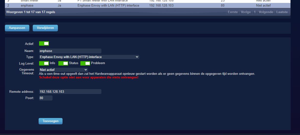

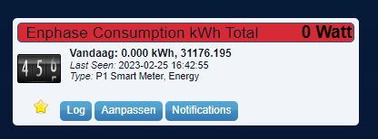

Hi, I just noticed that my enphase panels no longer pass their information into Domoticz after I upgraded to 2023.1. All enphase devices are shown in Domoticz with red title bars and show no more updates since the update.
Devices not getting any more updates
I have the Domoticz standard hardware for installed:
Enphase hardware
Enphase hardware
The http://192.168.128.103 address is showing me the enphase envoy screen in a browser correctly.
When I look into the Domoticz log though I find below messages just after I activated the 'enphase' hardware. Other than that I see no messages from enphase, even with full logging enabled.
2023-02-27 11:53:47.146 Status: enphase: Worker started...
2023-02-27 11:53:51.262 Status: enphase: Connected, serial: 121831009724, software: R5.0.55
2023-02-27 11:53:51.262 Status: enphase: Unsupported software version! Please contact us for support!
2023-02-27 11:53:52.717 enphase: General/kWh (Zonnepanelen Productie)
2023-02-27 11:53:52.740 enphase: General/kWh (Enphase kWh Consumption)
2023-02-27 11:53:52.837 enphase: General/kWh (Enphase kWh Net Consumption)
What could be the issue, and of course: how do i get to work again? This integration has worked like a charm since at least 2019. Please help!
log
