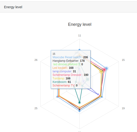

Just made the scan: My Energy levels are also looking much better now that a couple of days before. At least I have far more devices reporting an energy level.

Just a comment on that one. The report is made only for devices connected directly to the Zigate. All other devices which are reaching Zigate via a router won't be addressed here.waltervl wrote: Friday 28 February 2020 19:31 Just made the scan: My Energy levels are also looking much better now that a couple of days before. At least I have far more devices reporting an energy level.
